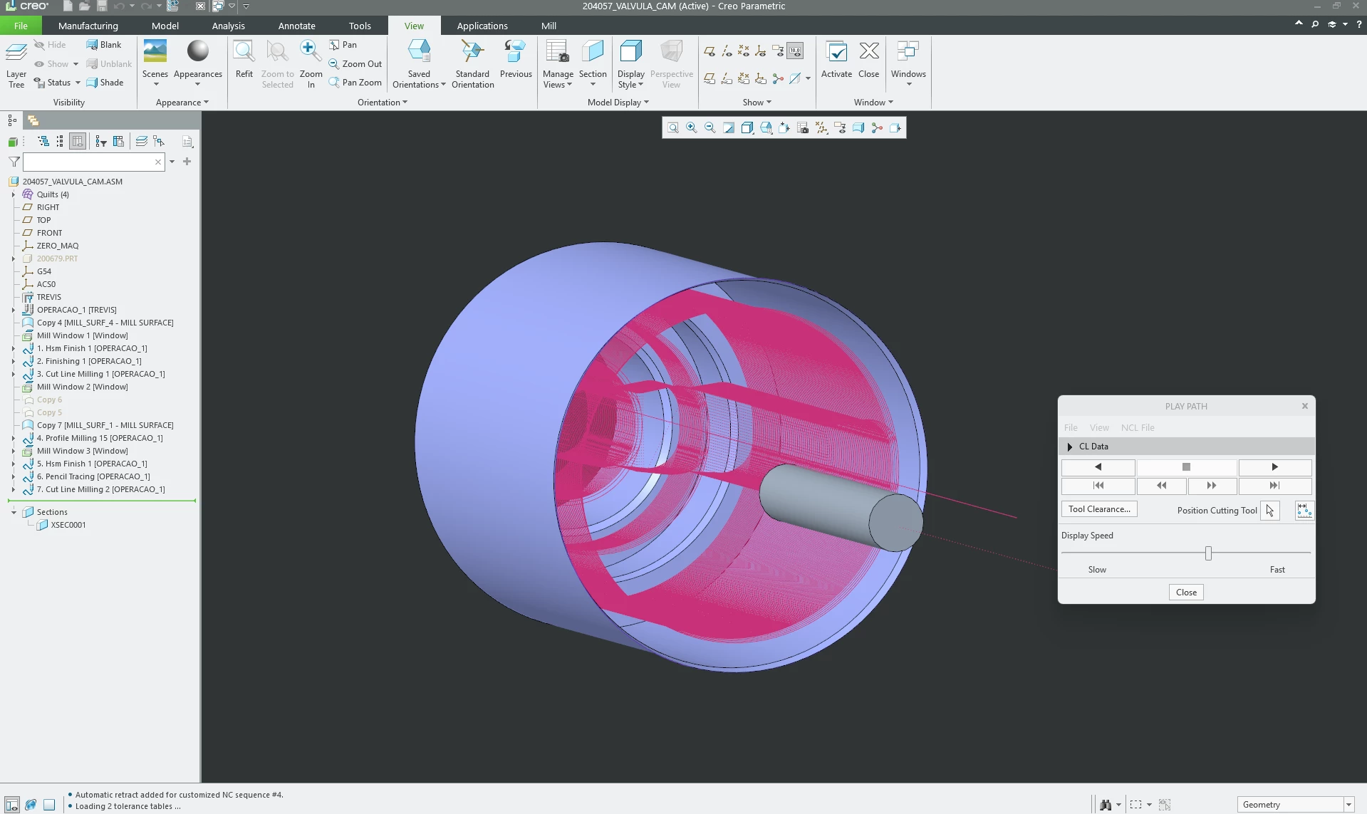

Hello CREO Users,
I am working on a milling operation for an internal profile (similar to a valve seat geometry) in Creo Manufacturing. My objective is to machine the internal contour using tool radius compensation (CUTCOM) and to ensure smooth ramp transitions between Z-level passes or using helical folling the profile to avoid marks on the final surface.
I have tried the following approaches:

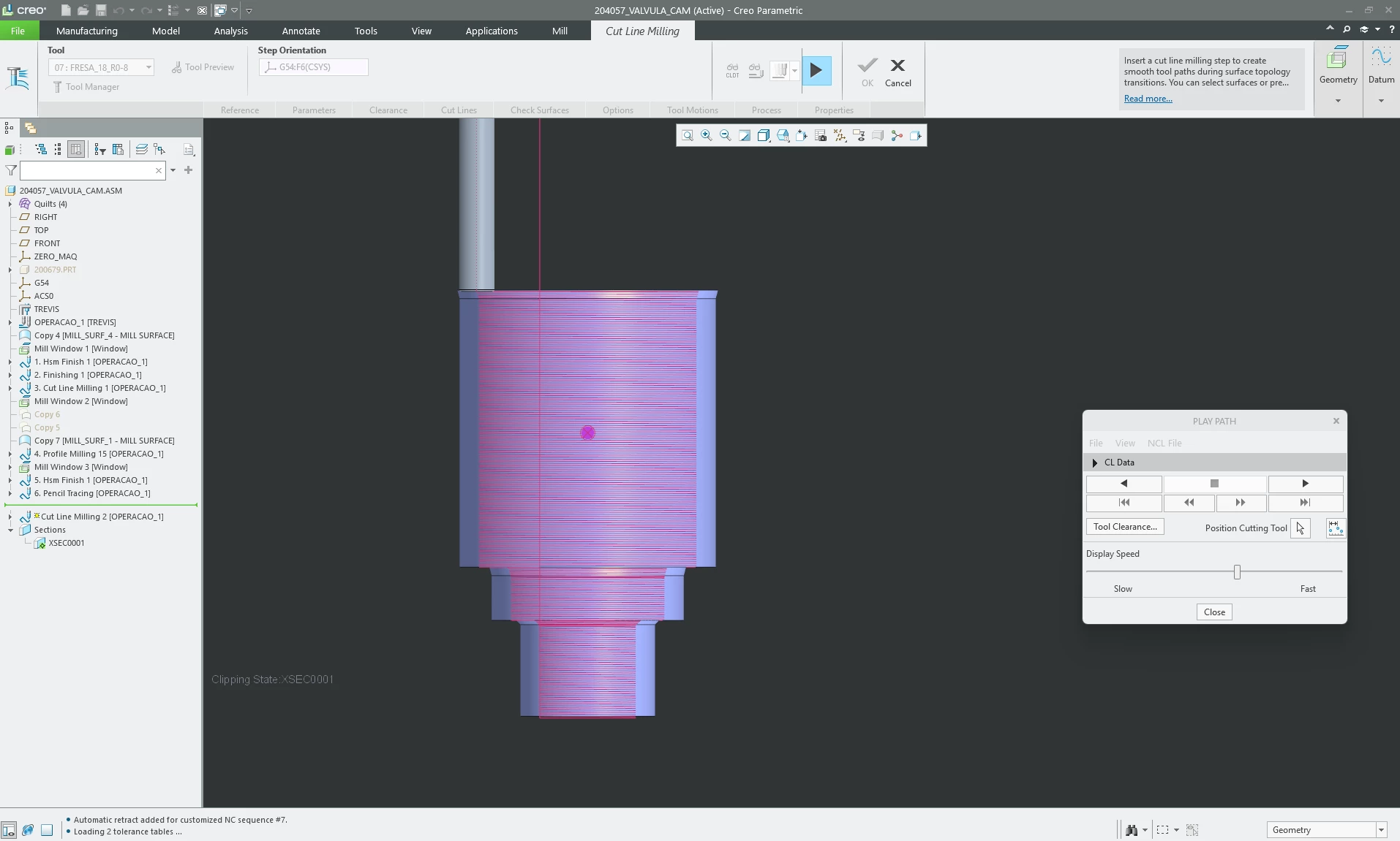

The Cut Line strategy allows helical movements and smooth transitions between passes, but it does not support tool radius compensation (CUTCOM). This is a requirement for my process.

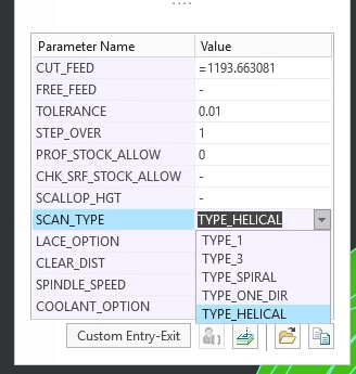

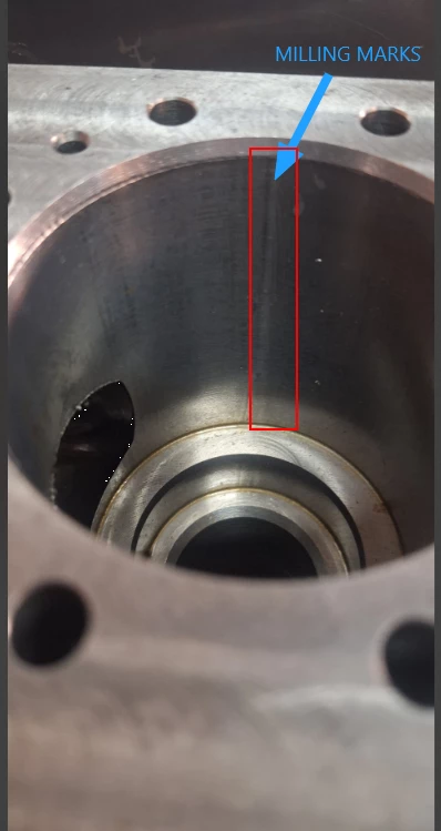

The Profile Milling strategy does support CUTCOM, but it does not offer ramp or spiral entry between Z-level cuts. As a result, the tool plunges vertically at each level, which causes unwanted marks and steps in the internal diameter of the part.
I've tried to explore all the SCAN_TYPE parameters. LEAD_IN and LEAD_OUT approach but nothing works well.
I need a solution that allows:
Internal profile milling
Tool radius compensation (CUTCOM)
Smooth ramp or helical transitions between Z-level passes
Is there a way to achieve this in Creo? Can you suggest any workaround or configuration that enables ramped transitions with CUTCOM enabled in Profile Milling or another equivalent strategy?
