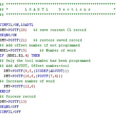

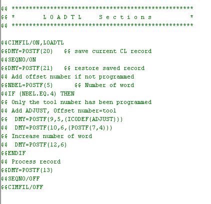

Sorry I didn't follow up and explain how to modify the post for testing purposes.
I would first copy the post to a different named file other than the production post you are currently using and modify the fil and do the testing on the copied post.
To test the fil routines you can put $$ in to turn the fil lines to just text. I would do one section at a time and post a file to see if it fixes the problem.
you can't hurt anything by doing it this way and you still have the original to fall back on. just make sure when you do a test of a cl file you use the modified post not the original.
