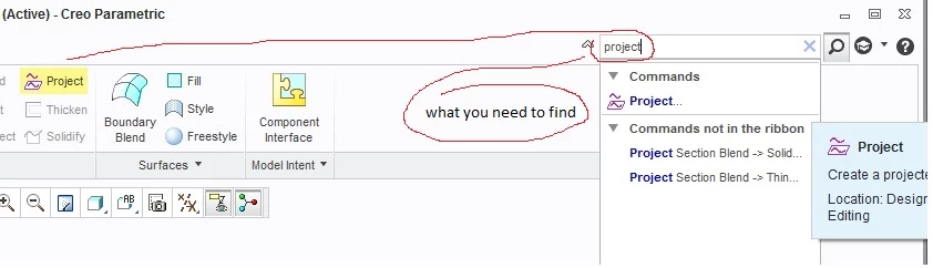

OK, I've found another reason Creole Swampware pisses me off. In WF projecting a cosmetic sketch (text) onto a curved surface was very simple. Click Project, select the surface and go at it. So where did PTC hide this basic, "simple" task's commands in Creole 2.0?
Any help? TIA!

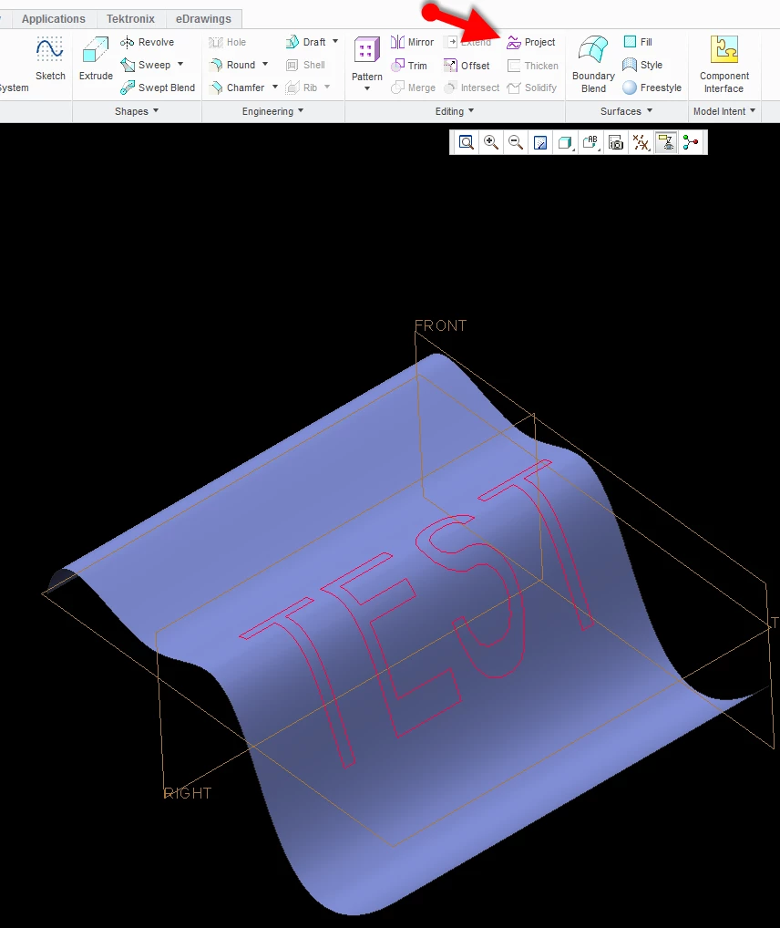

I was promoted to IT when we made the switch from Mildfire5 to Creo2 so I am now only a casual user. The command search has helped me immensely when helping others. Please see attached image.
