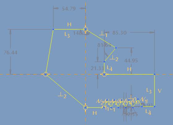

This might be hard to do, but it would be nice if there were an option to set the default zoom on new parts. When you are working on small metric parts it is hard to make the first sketch the right size. It seems to always end up too large. This causes you to have to scale the part and hope eveything moves correctly and you don't have any accidental constrants.
Many of our engineers work on handheld devices, so the internal parts are less than an inch. With the default sketcher zoom it seems that you always end up with 5 or 10 inch parts (or as in the picture below 76.44mm parts in metric, instead of 15mm).
Maybe there could be a config option to set the default zoom. Then it could be set to a value that is close to what most of your work needs.
September 10, 2010
Hi Paul,
The work arounds for this have been to make start parts (templates) with an initial datum curve of some sort that has a dimension that effectively sets the bounding box. So this is one extra feature in your start part and maybe you have a series of start parts depending on the part you want to make. I guess it would be nice to have a config bounding box setting (have not seen one but have not looked).
Regards, Brent

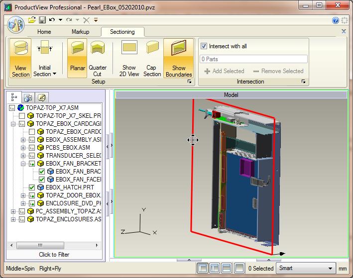

Creating section views in Pro/E is extremely powerful. If would be even better if you could also create dynamic sections to complement the fixed sections. For this I think it would be great to bring in the dymanic section technology from ProductView.
This would allow the engineer the ability to look through the model and check for interferences. With the technology in ProductView it is also great, then non-CAD users can check the systems.
Here is a screenshot of ProductView:
Forgot to put in that it would be nice if the cross-section interface was easier to use and much quicker.
September 23, 2010
dynamic cross-sections would be very helpful for sketching. If you're creating a sketch inside of a model it would be very helpful to create a cross-section on the sketching plane (with one click!). Maybe as an option: always_create_x-sec_on_sketching_plane yes*/no.
October 5, 2010
Making a section on any of the flat surfaces of the assembly and components would be a great help.
At the moment if I want to check the engagement of a screw I need to show the screw plane add a assembly plane and create a section. ( you can also create the plane during the section but the plane as to be created).

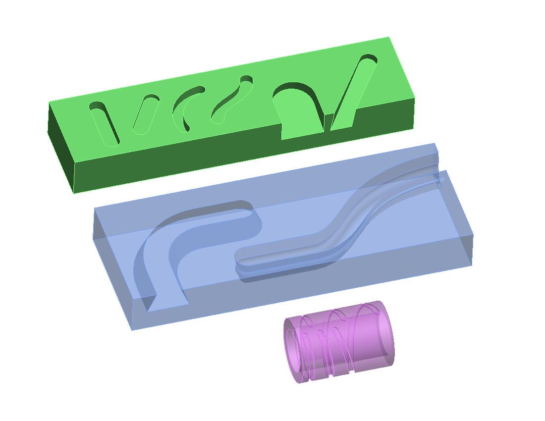

Folks,
Most of what we have been kicking around so far has to do with the User Interface, very important for clarity, efficiency, etc. Interestingly, this probably says--without saying--that the underlying substantive modeling capabilities are not where there is a deficiency. However, there is also room for improvement in geometry creation. The biggest thing I've wished for since I started (on 12.0) is a Swept Revolve. In other words: Give me what an endmill does!!! (More generally, what a rotating cutter does; and while you're at it, it might as well be capable of adding material in the same manner.)
All of this geometry can be constructed using various Pro/E feature types and techniques, but how much easier some of them would be if you could just lay down a trajectory (and a half section only if necessary) and be done with it! Examples above include simple slots on the flat, inclined cuts, & cam slots on a cylinder produced with a standard end mill as well as a dovetail slot and a slot created with a form cutter. All of this geometric reality is already present in Pro/Manufacturing, NC-Check, and Vericut; it just needs to be enabled for modeling.
Those cam grooves on the cylinder (from a "real" project) are part of a pattern; having to add the end geometry in that case, then Reference Pattern, was particularly time-consuming, and sometimes on the edge of successful regeneration, depending on dimensions, etc.
David
pwyndham1-VisitorAuthor
September 8, 2010
That is an excelent idea. It is always hard to get the end of a sweep to look like the end mill would create it. A swept revolve would be very helpful.
I was hoping for Geometry creation ideas like this, but I guess the ideas I put up so far were interface related. Thanks for pointing that out.
