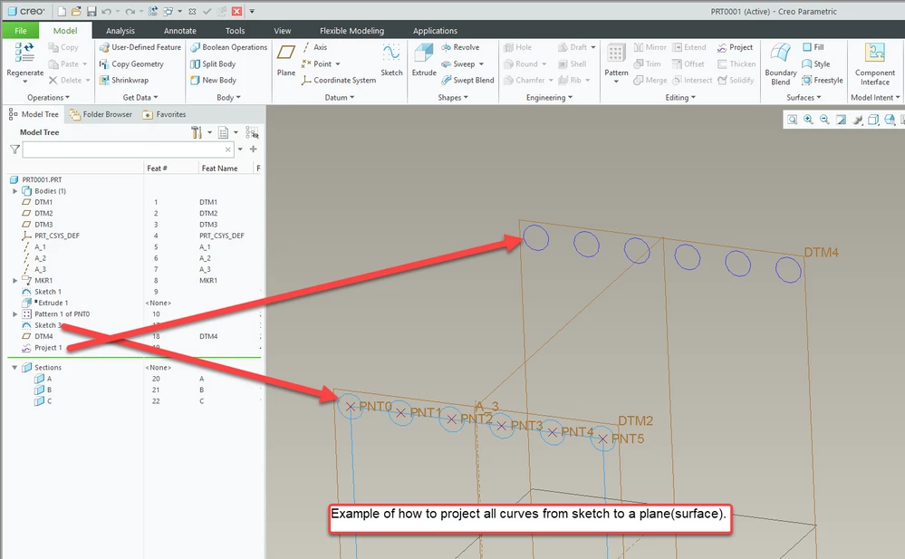

This is an alternative method that will work for some scenarios. Here a pattern of a datum points is used to define the pattern instance locations and then a sketch references these datum points to realize the design intent that you want.
Creo 7 model enclosed for reference.
