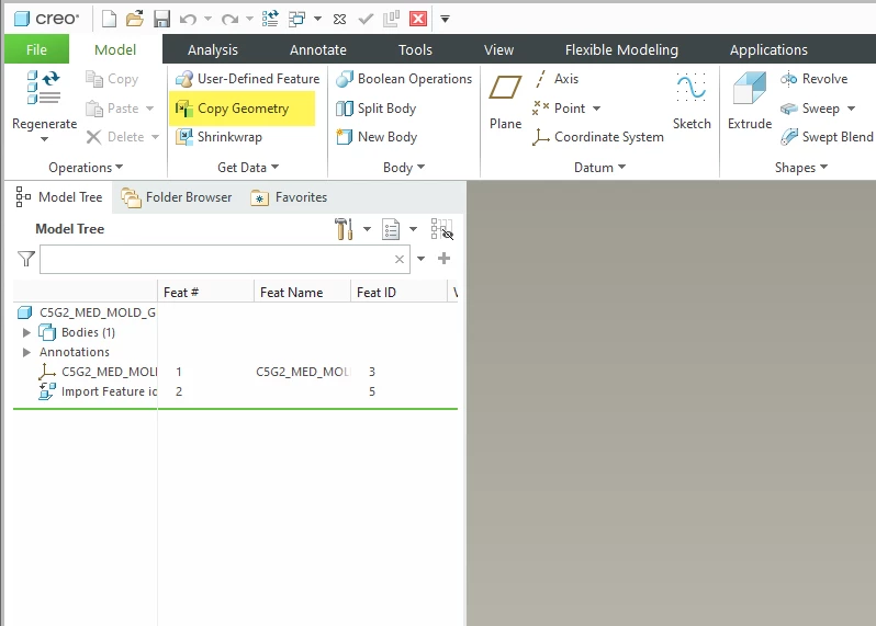

Can you confirm that you have the AAX license or equivalent? This would include the functionality of top-down design tools such as skeletons, copy geometry etc. If you do have access to the top-down design tools, then it would be advisable to use them in the context of defining a workflow for your organization.

Could you give me the keystrokes to find out?  I work for a small company with scant tech resources.  We have no I.T. nor any windchill admin.  We do it on the fly.  I have no formal training, just a few online tutorials and some solid OJT.  2 years.  I don't follow all the terminology advanced users are referencing.  The only reason we use Creo is because our larger customers like Caterpillar use it.

If you can use this copy geometry command, then you should have the license for top-down design tools.
To Create a Copy Geometry Feature (ptc.com)
