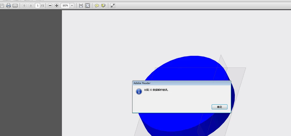

protoolkit: When ProPDFExport exports U3D PDF and opens it, it shows a 3D data parsing error无标题.png111.png

  • Can you describe the steps you have taken to export the U3D PDF using ProPDFExport in ProToolkit?
  • Which PDF viewer are you using to open the exported U3D PDF? Have you tried using different PDF viewers to see if the issue persists?
  • Which version of ProToolkit and ProPDFExport are you using, and what is your development environment setup?
Please add screenshot(s) to better understand what you are trying to do in your process.

您能问我吗
ZHeiTu4-ParticipantAuthor
May 7, 2025

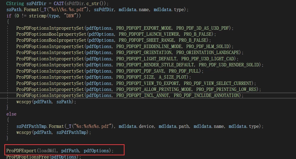

在屏幕截图中,代码显示,在使用 ProPDFExport 导出 U3DPDF 之前,设置了 PRO_PDFOPT_EXPORT_MODE=PRO_PDF_3D_AS_U3D_PDF 等参数。我使用了 Adobe Acrobat pdf 查看器打开的 pdf。开发环境为 Visual Studio 2019

The first thing you can try is to export the same file from the UI and see if the parsing error happens there.
Secondly, I'm seeing that you set a series of properties. Did you try by elimination ?
Just comment all but one property, try and iterate. This will help pin down the property that's not mapped properly (if I understand the error correctly).

I tried UI is used to derive the same file, and view the parsing is no problem, I tried to set up ProPDFOptionIntPropertySet (pDFpotion OPT_EXPORT_MODE, PRO_PDF_3D_AS_U3D_PDF) but there are still problems,
May 12, 2025
If the export from the UI passes then the issue lays in your code.
Try by elimination : set one property after another and iterate.
If this still fails, flip your methodology and re-use the code in the resolution of this article : https://www.ptc.com/en/support/article/CS61272
Make sure it works and then iterate to your likings.
