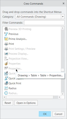

I am using V5.0.2.0 and I can not add the "properties" selection to my RMB.
I am trying to pull up the properties of a dimension, I have gone to the customize tab to add "properties" to the RMB however it is greyed out. There are several other selections that I am having this problem with. Any help would be greatly appreciated

The item is grayed out, may not be what you are looking for.  If you hover over the option, a help pop-out will tell you the path to that option:
StephenW

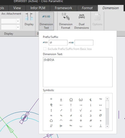

What I am specifically trying to do is replace the dimension with a letter for a tabulated drawing, however when I just use the dimension text feature in the ribbon it repopulates the dimension and then places it in brackets. In the older creo versions it was much easier to override that and put whatever you wanted. It was accessed in the properties pop up menu

You need to change the @D to @O and then a space and the the "A"  (or put the "A") in front of the @ symbol to avoid the additional space.

Thanks, that worked perfectly. As a general question, is there no way to add the properties pop up menu to anything now? I went through and added "properties" to every possible category and for the majority it is not showing up
