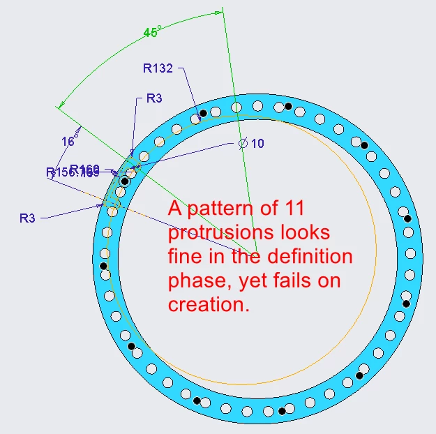

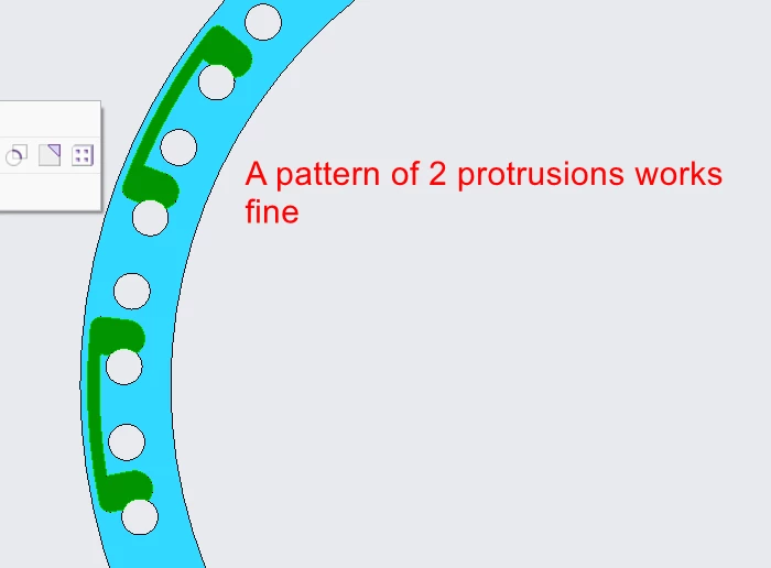

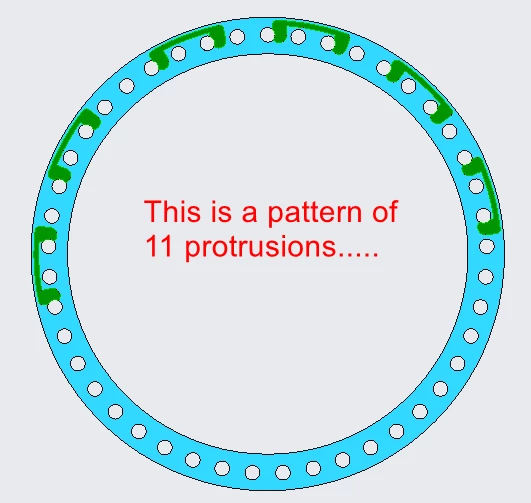

I am having a problem creating a circular pattern of a protrusion in Creo 4.0 .
The pattern should distribute evenly around a 360 degrees circle, yet it only fills up half of the circle. Some of the protrusions seem to overlap or just fail.
I am having this problem since day one of using Pro/E and Creo. Sometimes it works, sometimes not. I must be doing something wrong. Not sure what.

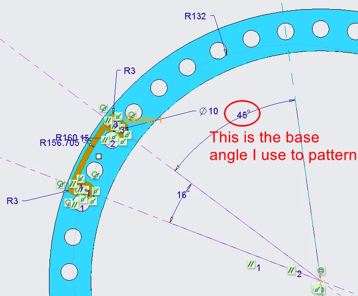

I tried 2 different ways.
- A dimensional pattern on the base angle of the protrusion
- A reference pattern of the protrusion, by first patterning the reference datum plane of the protrusion.
Both ways fail.
The pattern works, as long as the total angle used is less than 180 degrees. When trying to fill the full 360 degrees, the protrusions overlap or fail.
Screenshots are hopefully helpful to understand the problem.

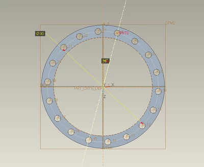

Sep 16, 2022 12:21 PM UTC
to get 360 degree dimension pattern you have to apply very old trick - create datum plane on the fly.
I uploaded video and part.
