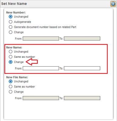

Are you sure you changed 'Name' and not 'File Name' or 'Number'?
There should be no problem with family table instances each having their own unique name (PTC_COMMON_NAME).

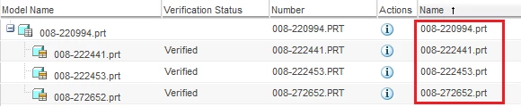

The Windchill side appears to be correct. But in Creo I have PTC_COMMON_NAME as a column on my model tree, and it is wrong there. Our CAD to ERP application uses the PTC_COMMON_NAME that Creo is showing in the model tree. I have tried renames, new workspaces, updating, syncing. We see this issue with multiple un related parts.
Correct in Windchill:
Incorrect in Creo:
TomU
Sep 13, 2022 4:20 PM UTC
From Creo in the workspace, a 'Tools' -> 'Synchronize' should update the workspace to reflect the name change in Commonspace.  What happens if you create a brand new workspace and pull the renamed models into that.  Does Creo show their new names then?
