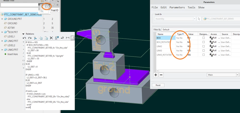

Hi, this remains an interesting unsolved case.
I can't open your Creo5 file so tried to make toy example similar to your new example - using similar structure of assembly level relations & pro/program code to drive constraint sets and existence of components.
Except I didn't use a value of a dimension to determine the logic of whether a component exists or is rotated - I defined Yes/No assembly level parameters:
Toggling these yes/no parameters and regenerating seems to work just fine.  Please try the attached model yourself.
So your code should work, I think, but there is something wrong:
- something in your assembly constraints that gives problems?  unlikely as re-edit-definition fixes the connections without picking new references
- using dimensions (real numbers) to define On/Off states - round-off errors causing the logic to fail?  - again, unlikely because it seems that the correct offset values and constraint set names are being set.
- bug ? - nah, this is PTC software 🙂
