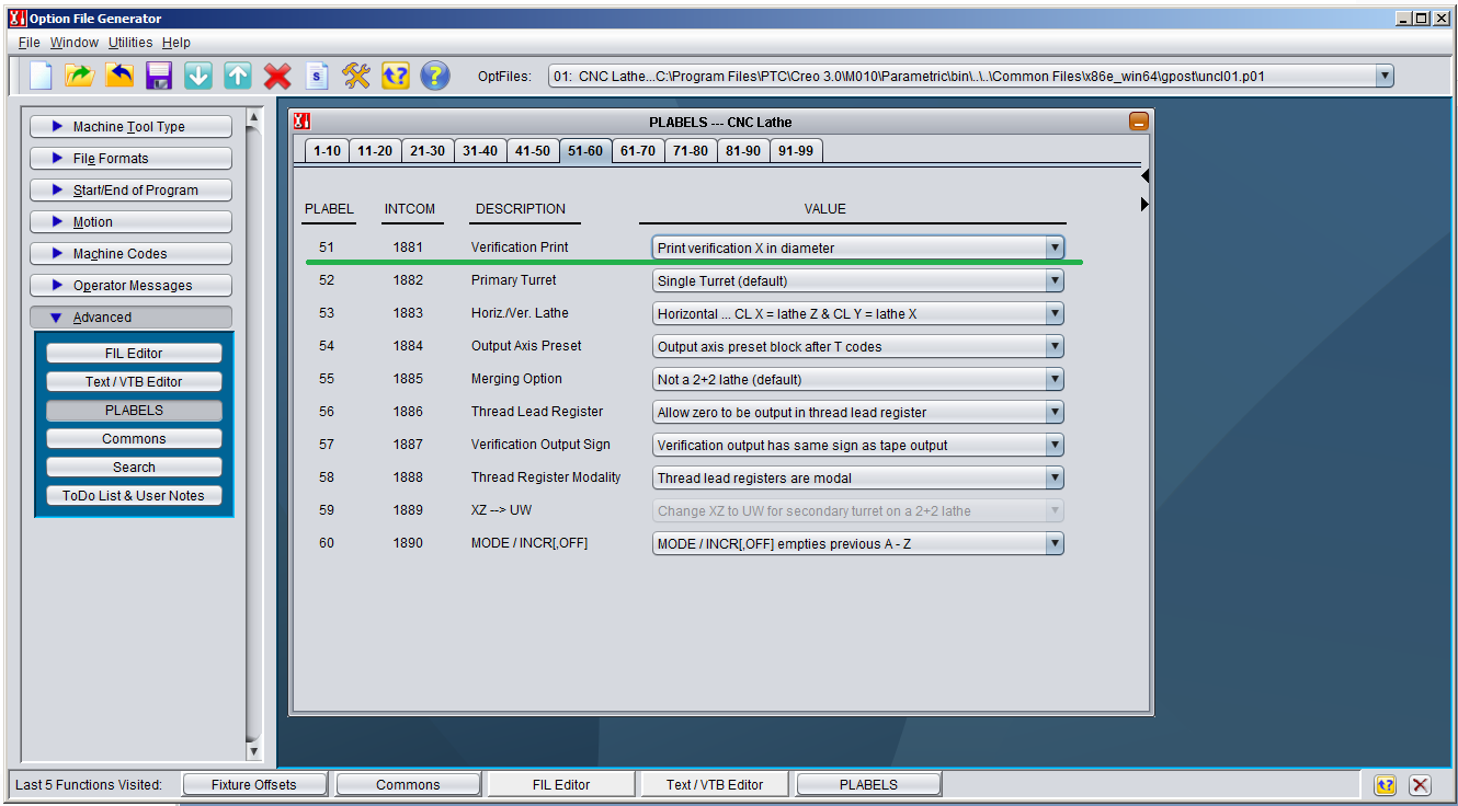

I would open your NC post processor and change PLABEL 51 to diameter. It may be set to radius.

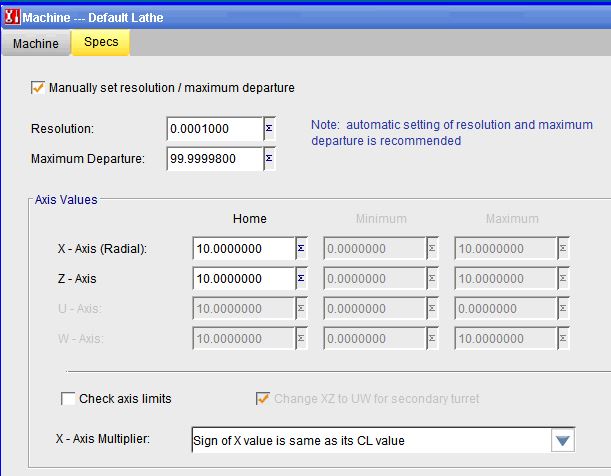

The setting Paul is talking about is not the right one.  You can change the post output to diameter on the Machine Tool Type -> Specs page where it says X - Axis Multiplier...
