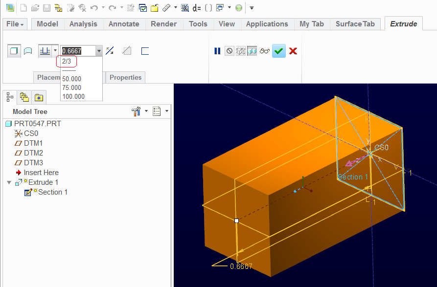

Here is an example of a "ribbon dim" change... compared to a section dim.
The .6667 was entered as 2/3. The value only takes on the value of the number of places designated.

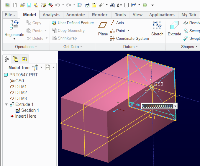

Unlike the dimension added in a section, where the value 1/3 remains .33333333333333 and displays as .3333.
This really is a problem with me. Anytime I use a arithmetic operation for a value, I expect that value to remain to the maximum number of places without having to re-edit this value later. If I go in and change the properties of the extrude depth dimension, I can set it to 4 places, rounded, and use the same calculation of 2/3 and it remains .666666666667 and shows as .6667. Now when I edit this value in the graphics screen, the popup shows .666666666667 as it should have in the 1st place.

Example of Ribbon Dim...
Section Dim
