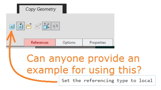

December 3, 2019
Being new to Creo 4, I just noticed there is the "local" referencing available in the copy geom feature:
Usually I use "external" or "assembly" referencing.  I'm curious if anyone uses this "local" referencing to copy geometry - and why?
