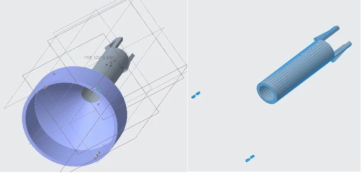

Purple section of model getting lost on export. How to fix?
i'm trying to export the model on the left as an stl. However, parts of the model are disappearing. What would cause such behaviour?
Kind regards

That purple color of the model indicates that it is not a solid but just surfaces. STL can only export solids.

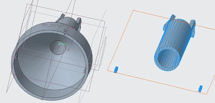

With that response, I used the solidify option on the purple section. Now it's all grey, however it still doesn't export that section. Is there anything else I'm missing?

Hmm, not sure. Are there any warnings or errors? BTW, what version are you on? There's a good connection between the bell section and the tube right? not like a single edge connecting them or anything? from this angle I can't tell exactly what's going on. Can you post the model?
