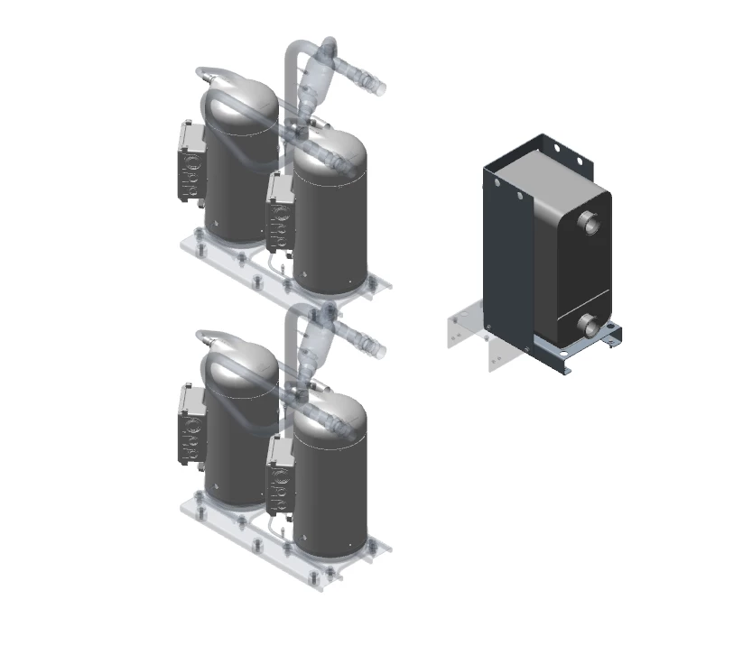

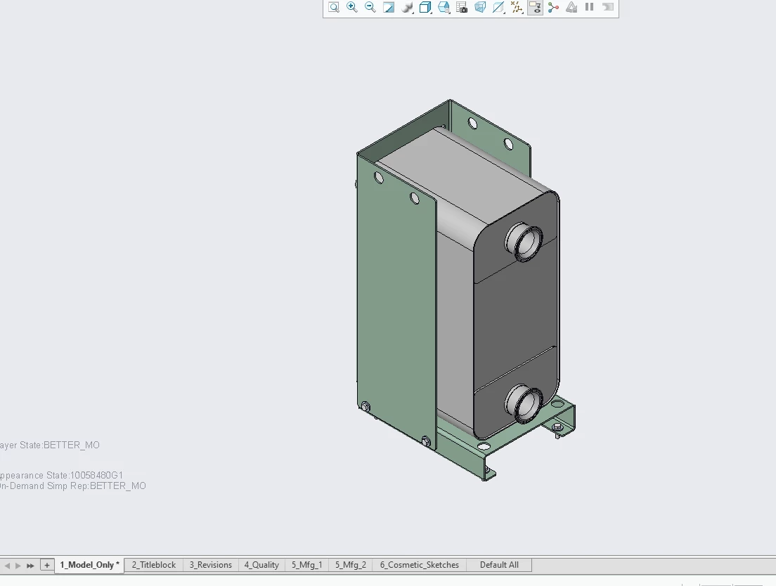

I am trying to generate a PVZ file using simplified reps to only show a part of a bigger assembly. In the Annotate tab of CREO I have the correct components on display but when I export the file to CREO view I get extra components that should be hidden. Any idea of why this happens and how I could fix this? I have attached photos of the CAD view and the PVZ output below.
