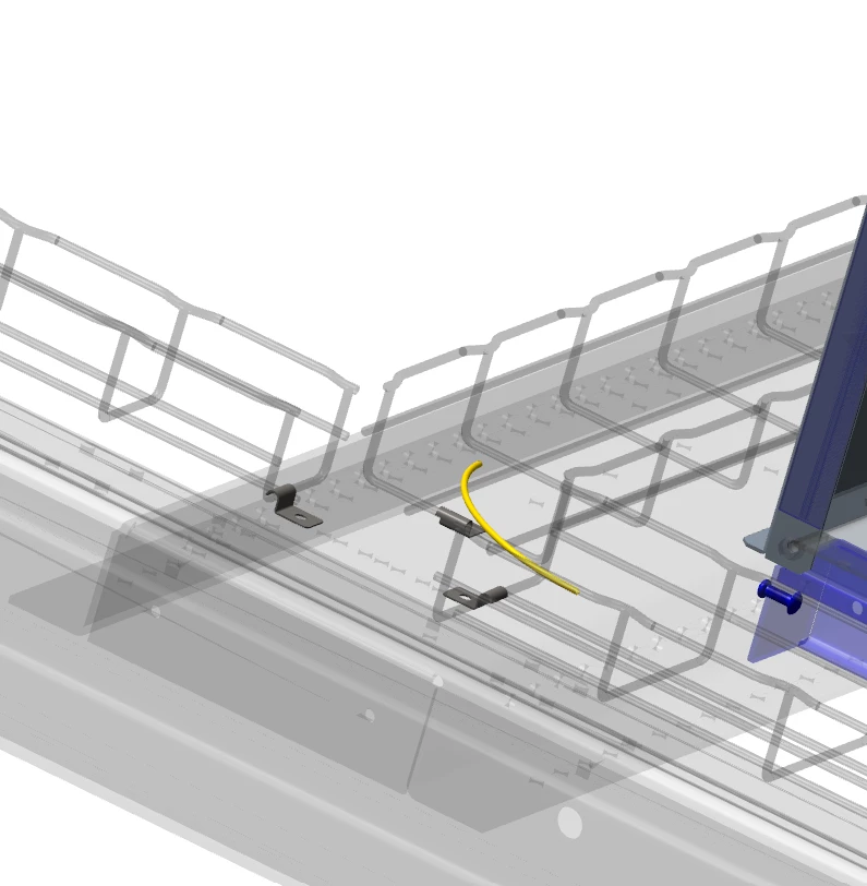

When the PVZ is done, the straight cable segments not appear (curved cable segments appear),
i tried to add this sentence into recipe: adapter/convCables=1;
then, setting a master representation of the cable;
then, giving a black color (in case of unwanted transparence);
and creating a new layer adding the cable (created using "cabling" application) as show and later as isolate;
in Creo all is ok...but, when the pvz is created only the straight cable sections are missing.
Do you know why this could be happening?
Regards
(I using  CREO 😎
Apr 5, 2024 6:04 AM UTC
try reproducing the problem on simple assembly -AND- in case of success send this data to PTC Support.
