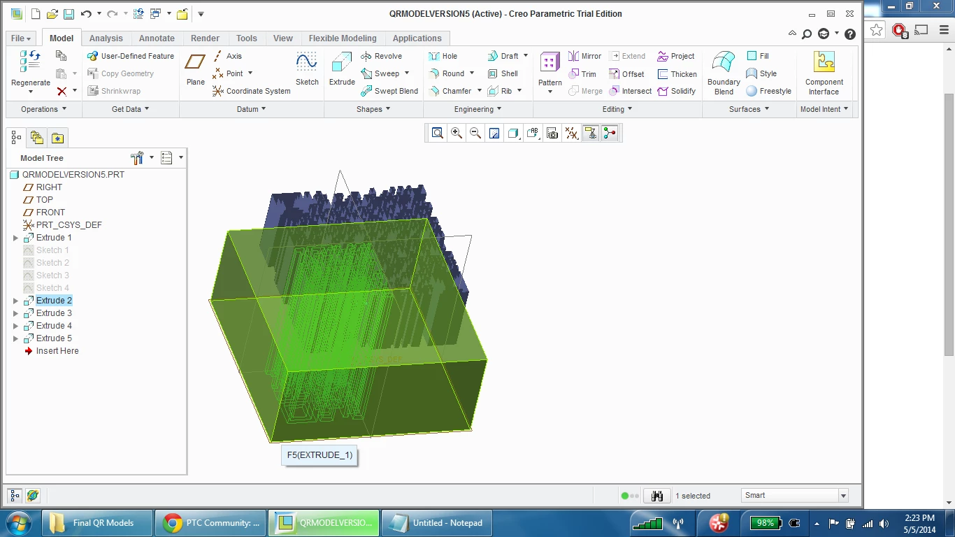

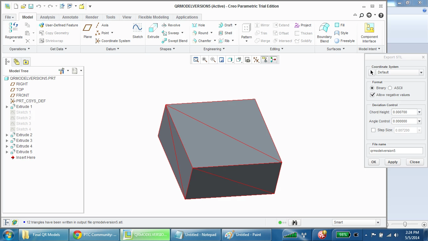

I am trying to create a 3-dimensional QR code model and print it out on a 3D printer/makerbot. I have created a model on creo parametric but when generating the .stl file, all the extrusions and features are lost. It just becomes a flat rectangular prism. Can anyone give me advice here?
Also when I create extrusions, they are hollow and not filled. I would like the QR extrusions to be solid filled but I can't do this. Have attached my model.
Appreciate the help!

Some screenshots of the issue
May 5, 2014
Your extruded QR is a surface. You cannot export to STL using surfaces. Only your block is being exported.
May 5, 2014

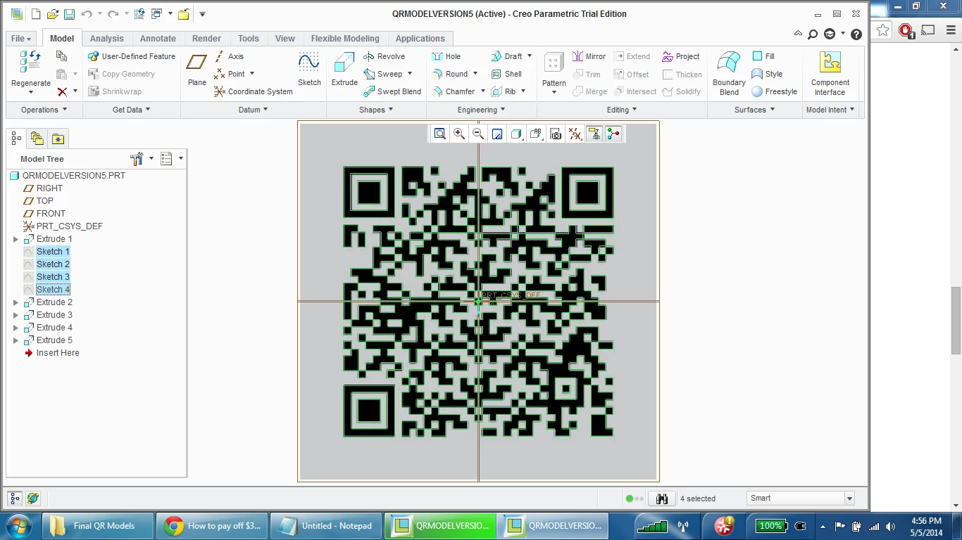

I imported an image of a QR code onto Creo and mapped it onto the model. Then I attempted to resketch the entire QR code (4 subsketches for each quadrant) and extrude it. I attached a screenshot of it.
I tried extruding as a capped surface but it would not allow me to do so.
May 5, 2014
That is a lot of work, Sadaf. You will have to go back and close many of the intersections and probably need a lot more sketches. you know you have a closed sketch when it is highlighted with a color for the enclosed region.
Try copying the sketch many times and make each solid path a sketch and make sure it is closed. This should get you what you are after.
