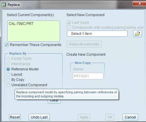

I worked at one company that did some avionics related work. One of the biggest single problems they had was swapping out clamps per customer design reviews at the end of projects. They had roughly 6 different family tables of clamps, and they were all modeled differently and in different orientations. Some of them had the default coordinate system at the center of where the routing of cables went through and some were facing left or others right, I think there may have been one or two that were modeled so they were extruded in the Y direction.or X direction, rather than all being in in the Z direction. To top it off there was also a glitch with some of them, they would often "flip" when you set them to fixed, I believe this was due to someone defining the coordinate system so it conformed to Catia's orientation, where I believe the Z direction is up rather than toward the user.
Anyway, due to this difficulty they didn't really do their harnessing the way it was supposed to be done. I don't know harnessing that well and don't know all the particular, but they were just routing a basic harness to represent the routing to customers.

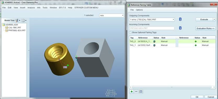

I developed aclamp model that I believed was the most practical solution. It was difficult to develop, and utilized many of the things I had learned over the years. One model containing all of the clamps that would be used. It would definitely streamline the process of swapping out clamps, AND preserve routing references as well. I no longer work there, as far as I know it's possible they they are using them now, but at the time they weren't utilized although the head of engineering originally said we should. I think the main problem was actually that if they worked as well as I expected them to, that others would be in trouble for all of the difficulties they had with routings over the years. Most of the "concerns" voiced were pretty silly to me, one being how to tell what generic an instance was from.
So basically, I'm wondering if I was right or wrong, I can't see how they wouldn't improve the situation, and potentially totally resolve difficulties with swapping out clamps at the last minute, or even earlier in the process. I thought it was an acheivement to be able to get all of the clamp variations in one generic model.
This is a Creo 2.0 model.
