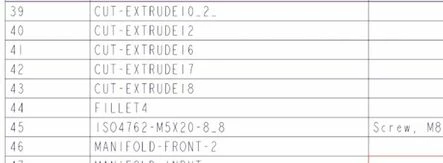

  1. How to excude out assembly level features in the BOM?

@Mirui wrote:

You can add feature ad assembly level, that's why i got line 39-44
I know how to create assembly feature ... but I have never seen assembly BOM containing assembly features.

Just to follow up on What @MartinHanak said you can filter on name as well:
Table Tab -> Repeat Region -> Filters -> Pick BOM Table -> Edit
Then put add the line below or customize it as needed
&asm.mbr.name != *CUT-EXTRUDE*
