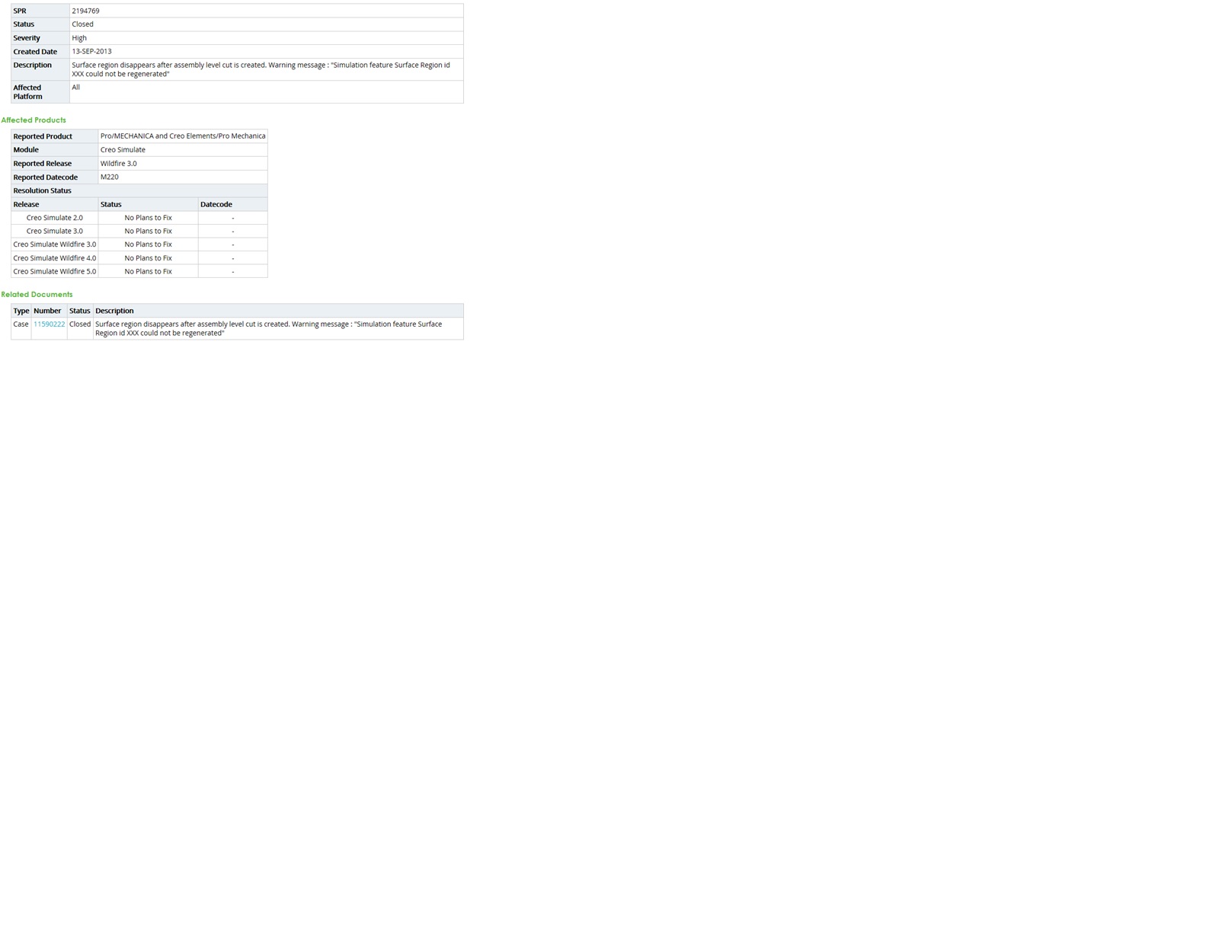

Am I (and my colleague) right in thinking that surface (and volume) regions are part-level features, and therefore cannot be created on surfaces resulting from an assembly-level cut?
If so I may submit an Idea...
Thanks!

Yes, surface and volume regions are part level geometry features.
The behaviour with surface regions and assy cuts has varied with release.
A long time ago (version 18 ish?) the work around to create a surface region on a component that then sees an assy cut was to open the part and create the region in part mode. The region (or partial region) was then available in assy mode. I am sure I got this gem of wisdom when I was at PTC, a methodology document written by a Mechanica Consultant other than myself.
Anyway, this was ok until about WF4 M150 when I noticed the behaviour changed.
I did what I always do and the surface region was suppressed when returning to assy mode.
Then another release it was back to the good ol' days.
Then not.
I commented here and raised a call that was initially closed as 'working to spec'. The call then became confounded with how failed simulation features are handled; not the original reason for the call.
The fact that it used to work didn't seem to be investigated.AAArrrrrgggghh.jpg
I now have to go through the painful exercise of cutting parts up
Perhaps the work around worked due to a bug?
I liked that bug. Give it back.

Dear Jonathan,
you have two ways to cut surfaces or volumes from parts affected by assembly-level extrusions:
  1. In Creo (not in Simulate) select the assembly-level extrude (necessarily a cut) and use the command "Model Intent" Designate. With it you can force the assembly-level extrude to be "copied" inside the single parts. You can also chose if to synchronize it or not between assembly and parts. Once the extrude is in the part, the part should become modifiable by Simulate.
  2. Open the part that has the surface (volume) you need to separate. Access Simulate from the Part, and cut the surface (or volume) from there. The cut will be inherited by Simulate opened from the assembly.
