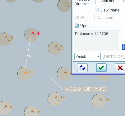

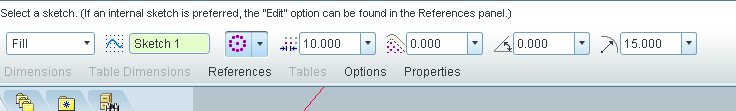

We're having some problems with the radial increment not being correct on a part with a concentric fill pattern so I made a very simple part and I'm seeing the same thing which makes me feel like I'm misunderstanding something...
I am trying to make a pattern of holes in a concentric circular pattern to fill a given space. I create a hole at the center and then use a fill pattern with concentric circular pattern and enter the desired radial and separation spacing - seems like it should be easy... [cid:1817ecd0-bc42-4834-82b0-2f712f835220]

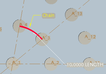

When I measure the spacing distance it is exactly what I entered: 10.00:
[cid:1602a781-3d77-4ce5-8d92-2934647538b2]
But when I enter the radial distance it is always a little off from the value I entered - in this case I entered 15.000:
[cid:14dfef9c-7ae8-4b35-b2d1-477419df2c5a]
Can anyone explain why this is? I have a call in with PTC but haven't gotten any response yet.
