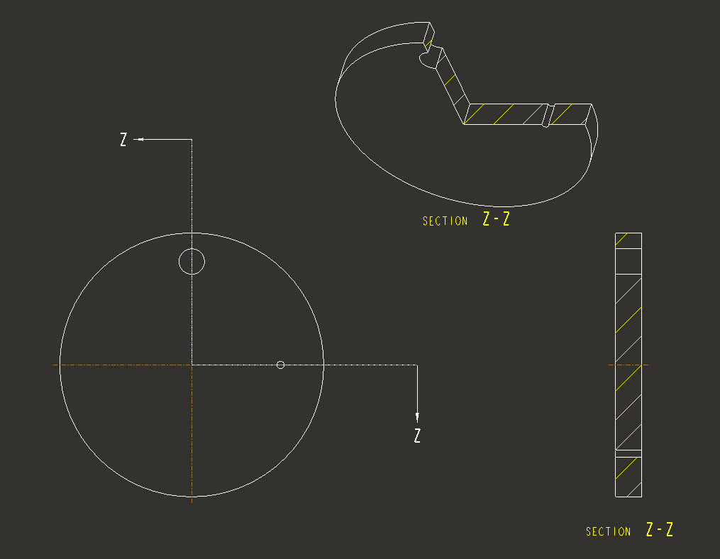

Using Creo 2 M110. When the dimension of the hole of radial axis pattern is shown on the view, where the cross section doesn't go through the hole, i.e. the hole is placed outside of cross section, the dimension doesn't fit to the actual hole axis (see figure below). I haven't had problems with that before but I might change some drawing options, however I don't know if those are the reason and which one would affect this behaviour. I would need advice, what is the reason and how to fix that.

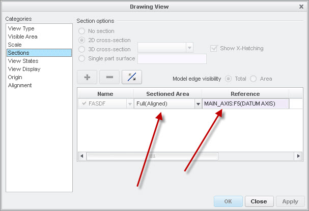

If the cross section doesn't go thru the center of the hole, you can not "fix" this with a drawing option.
You can however, make an offset cross section that goes thru the hole and then use full (aligned) and select the center axis of the part.

In the old days (WF3), when the hole was not on section plane you could show axis and then place the dimension for that specific hole with axis shown. Dimension was placed right on the axis. If you would try to create draft dimension for that axis it would not show correct length/diameter, whereas shown (model) dimension was showing correct diameter.
As it may be seen from the picture in my original post, axis is shown correctly (in the center of the green - selected - hole), whereas dimension of that hole is shown on its original place (where it would actually be if the view section would be oriented parallel to the screen) and it doesn't matter for which hole on pitch circle I try to place the dimension for - it is always shown on presumed to be place.
