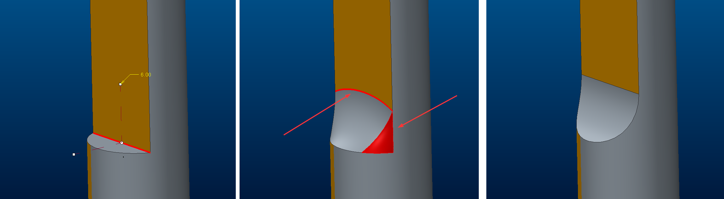

I´m trying to make a radius in the edge shown in first picture. The result I get is the second image. I want to achieve the third image only using a radius feature, how can I do it?

In the Sets tab try using the extend surfaces option. That should work.

Mark Peterson is spot on.

That´s it. Thanks.
