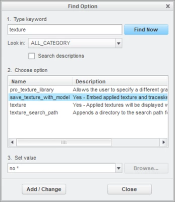

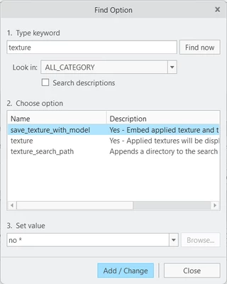

8-Gravel
Sep 1, 2022 2:36 PM UTC
Hello - thanks, that worked for me! I thought I had searched thoroughly for that option, but apparently I didn't:
Creo 2.0:
Creo 9.0:
