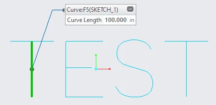

A handful of years have gone by since I asked the question on whether it was possible to either generate your own 2D text style font or import this from an outside source.
By any chance has this become easier to do?
My goal is to have a set of text characters that are matched to the text font used with our hand stamps.  The 3D characters do not machine correctly.
I did a lengthy Google search but couldn't find any solution.

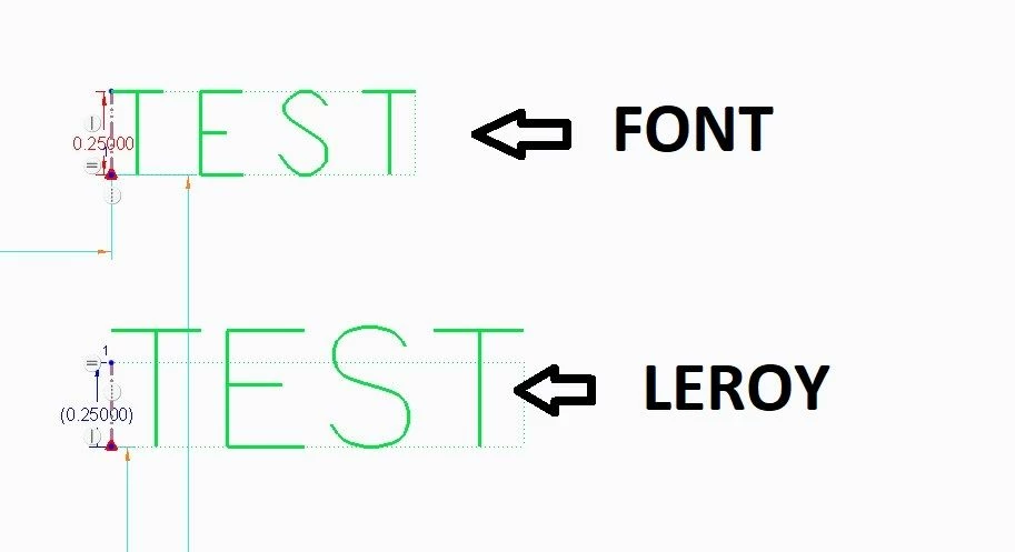

Please explain why Leroy characters are larger than you expect. I do not understand your problem.
The scale with Leroy is larger than the specified size.  I'll show an example between "font" and "leroy":
Notice how "font" stays true to the text height.  Conversely "leroy" is larger scaled.  What I'd like to find out is whether it is possible to alter a setting to proportionally bring the text to the correct height.  I see that the height in the src header is 63 which is the max.  The width is specified at 36, but also there is an ICS of 1 and fixed width of 1 which likely means the individual widths take over.  Would it be possible to make a universal height change to all text characters?

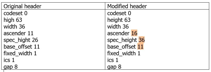

Problem: The scale with Leroy is larger than the specified size.
The result of the examination: It is caused by bug in leroy.src.
#73
"I"
width 16
m 8,47
d 8,11
Definition of the above character ends at 47.

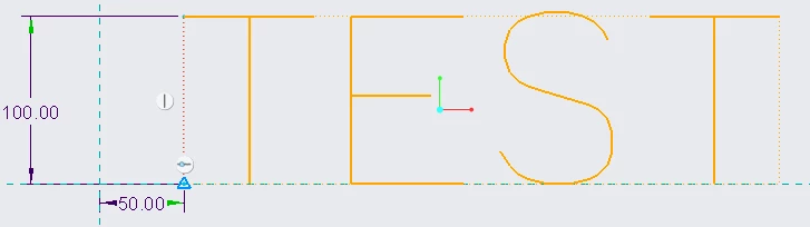

base_offset + spec_height must be 47 ... therefore I set spec_height to 36
base_offset + spec_height + ascender must be 63 ... therefore I set ascender to 16
I compiled modified font and created new Sketch feature in new part and result is OK.]
