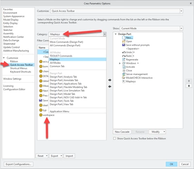

StephenW
Sep 14, 2022 6:56 PM UTC
I'm not sure what the video was, that was several community migrations back.
If you are asking about adding a mapkey to the tool bar, you can go to file options and add them to a quick access toolbar.

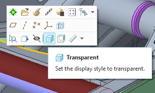

Sep 14, 2022 8:21 PM UTC
I have a map key I created a few years ago, but now also have transparent and solid added to the quick access tool bar.  If i click on a part the button is right there.

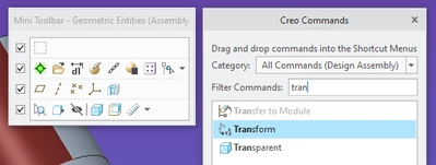

Sep 14, 2022 8:28 PM UTC
Hi Kdirth,
If you don't mind me asking, how did you get the Transparent added to your quick access toolbar?  I'm using Creo 4.

Sep 14, 2022 8:54 PM UTC
RMB on tool bar and select Customize:
Search for Transparent and drag to toolbar:
