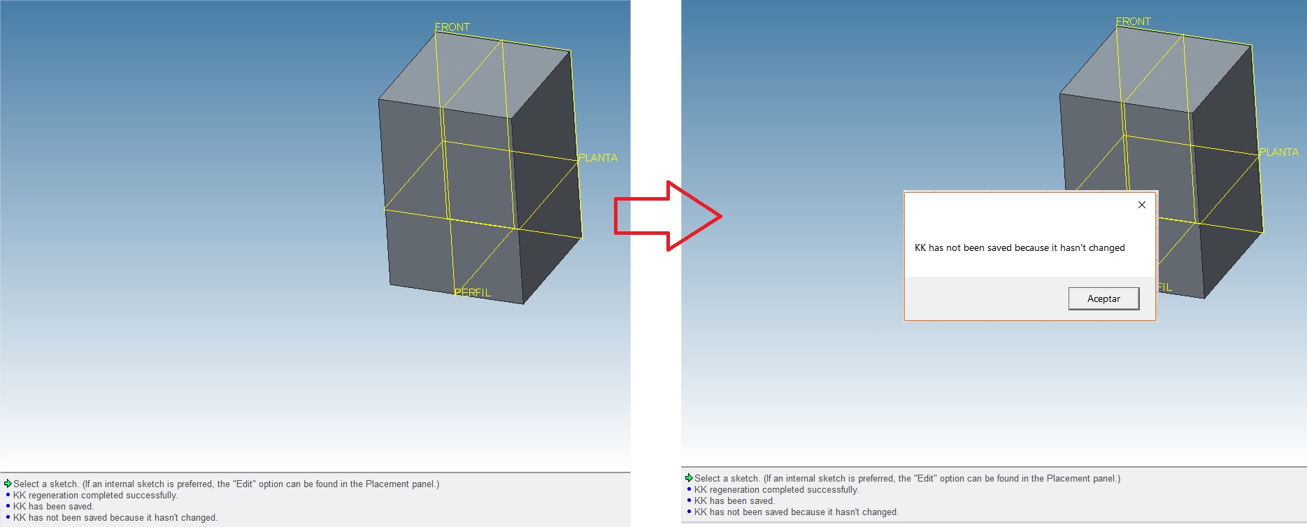

Is it possible with some API to read the Message Log of Creo Parametric?
I would like to do a pop-up message box when an important message appears there...
"circular references" or "not saved because not changed" for instance...
Thank you
Best answer by sjuraj
Not sure how about Toolkit, but I think this is not possible.
You would have to create listeners manually and display messages depending on specific situations.
sjuraj15-MoonstoneAnswer
April 27, 2017
