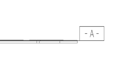

Refer to the below screenshot, just now I tried to make the datum symbol in an assembly view to disappear (delete or erase), but there was no user-friendly approach to do it.

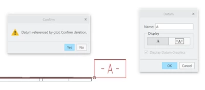

Eventually, after I had applied some optimization searching methods that I learnt in graduate school, i.e., educated brutal search method, I found a way to delete it. (See below screenshot).
In brief, when I clicked the left button in the popup Datum property, the left window popped up, and there was a delete function! Cheer!
