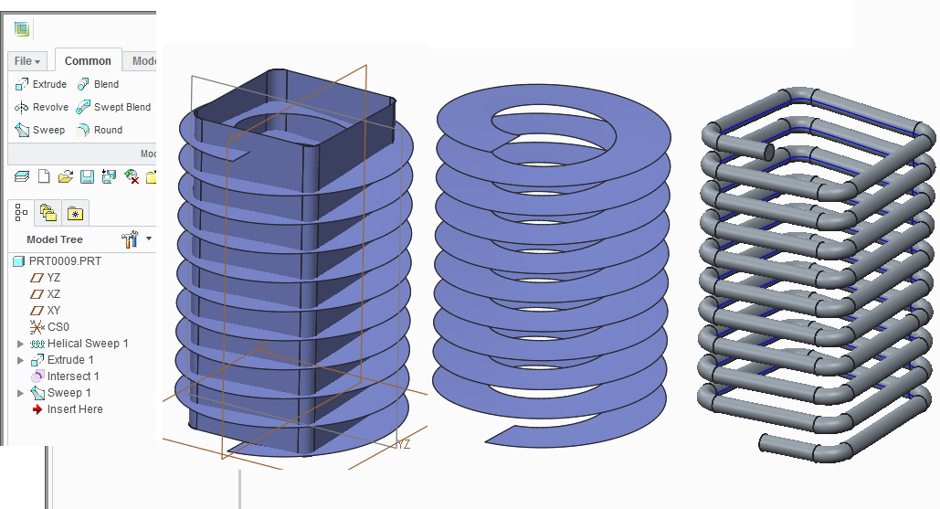

April 16, 2013
Helical sweep as surface
Rectangular extrude surface along axis of previous feature
Create intersect curve between the two
Use curve as sweep profile
See attached image
Cheers, Sean
April 16, 2013
Whoops! images where in the wrong order in my attachment.
