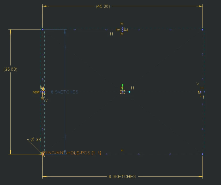

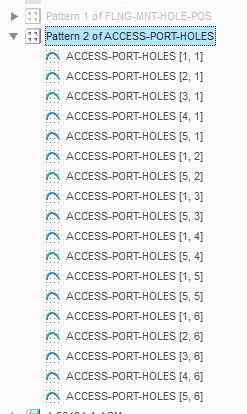

I have rectangular flanges that I have to create hole patterns for. I usually start with making a master cad file that has some automation to it, which allows me to make quick adjustments to the assembly for modified versions/sizes of the product. Rectangular hole patterns have been an issue for me.

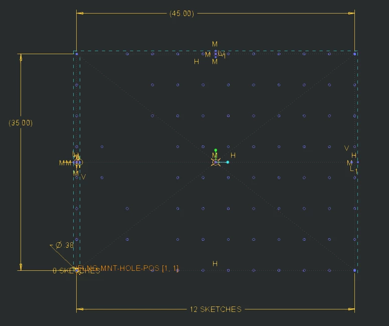

My current method is this. I create a rectangular construction sketch, using the center of the hole/duct as a reference. I put a point or circle in one of the corners of the rectangle. I then pattern the sketch using directions, with a relation that takes the length of each side and the number of holes and drives the hole spacing for each direction separate. However, that gives me all of the holes in the middle that I don't want. I just need the outline, so I go in an deselect all the center holes by hand. It's tedious but it works. The problem is when I have to adjust the number of holes, then I have to go through and fix all the selected/deselected locations.
The outline pattern option doesn't work, as that only allows one value for hole spacing for both directions. Fill does not work either for the same reason.
Is there another relation or method I can use? I see that the pattern gives the X,Y position in the tree (HOLE [X, Y]). I should be able to use that to filter out any holes that aren't on an outline position, but I don't know how to access that parameter. I want to keep it all in one pattern, because that will let me use the reference pattern feature when adding hardware to the model in one shot.
Attached pictures are going from a good pattern, to adding additional holes and the resulting pattern afterwards.

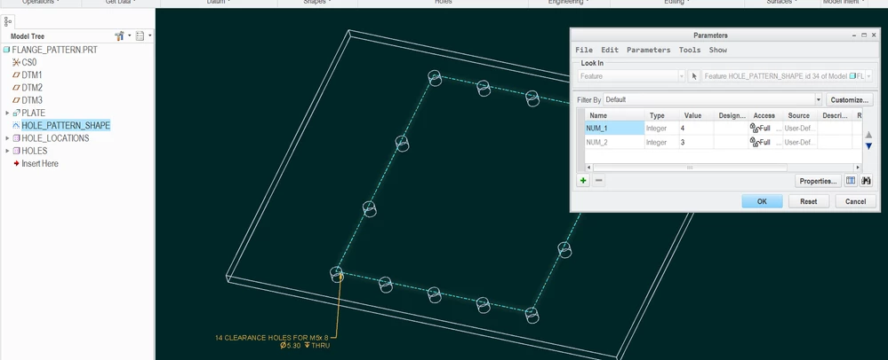

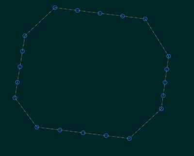

Well, your case intrigued me and I came up with this solution:
You can place a point at some distance along a curve.  Then this can be turned into a dimension driven pattern of points.  And pattern relations can be employed to produce different spacing for the different side lengths of the rectangle.  The end result is a single hole pattern that is driven by the sketch feature:
Notes:
- in this implementation, couple of parameters defined in the sketch feature specify how many "spaces between holes" exist on the long and short sides of the rectangle
- there is still a need for 2 patterns because you can't use points on curve as the basis of hole placement.
Feel free to adapt the attached Creo 2.0 file to suit your needs - and if you can, please share any improvements.

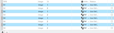

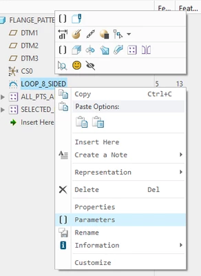

Hi @AlexK , I don't quite understand what you are asking, but with reference to my last post and the model flange_pattern_8_sided.zip,
you can change the "LOOP_8_SIDED" feature parameters "N1" - "N8" to vary the # instances in the 8 segments of this sketch.
For example:
Generates this:
And you are also quite free to modify the shape of the sketch LOOP_8_SIDED
(by dragging the vertices of the polygon - do not delete entities or dimensions or the relations will break), e.g.:
If you are asking how it all works, examine the pattern relations inside "ALL_PTS_AROUND_LOOP" pattern feature and feature relations inside the "LOOP_8_SIDED" sketch.
Now that I look back at this critically, it is rather too complicated for its own good.  Good luck!

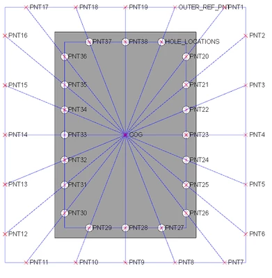

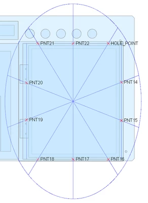

I often use the method using four patterns that @dgschaefer refereed to, but was looking for something to save on all the copygeom features when using top-down modelling. I really like the method @pausob described using relations, but can't figure out how to start the pattern a  away from the corners (other than manually turning off each corner instance)
By using an outer reference sketch, the distribution of holes on each side can be controlled. I've attached an example part, but the images below shows what I mean. I tried the ellipse first, but think the reference rectangle gives more control. It's probably only worth it for top-down modelling.
Sam
Rectangular hole pattern using reference ellipseRectangular hole pattern using reference ellipseRectangular hole pattern using reference rectqangleRectangular hole pattern using reference rectqangle

@pausob ,I tried to do that, but lack your wizardry with Creo relations, so gave up.
Sam
