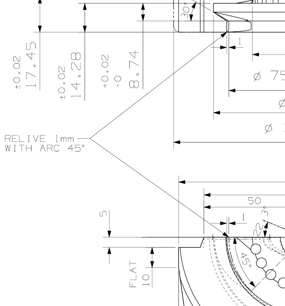

Hello sir,
Will you pls tell me how to create relive 1 mm arc with 45 degree as shown in attached file?
Jan 15, 2021 9:30 AM UTC
@ptc-5398568 wrote:
Hello sir,
I am sorry I can't.
