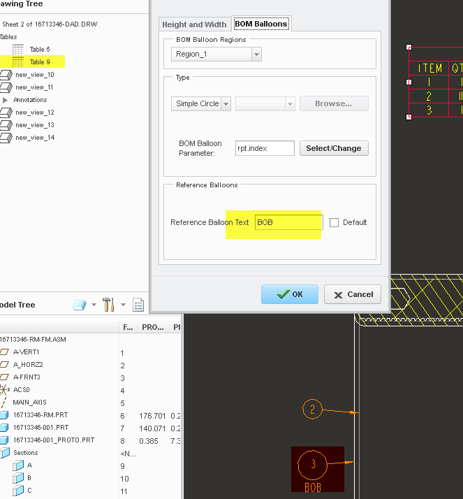

We have been using Reference Balloons on detail views for years and they have been appearing with the letters REF under the balloon, which is what we want.
Today, one of the engineers went to add a reference balloon and instead of REF, he got "Default". I created some new parts, a drawing and a detail view, added a reference balloon and got the "default", also.
If I add Reeference_bom_ballon_text to my drawing options and set the value to REF, a new reference balloon comes in like it did before.
What is strange is that we have not updated our Creo2 install in about 6 months, so why is the software suddenly giving us things we don't expect.
Creo2 m220
Windchill10.0 m040
StephenW
StephenWAnswer
April 25, 2017
How about the your BOM table file? It can be saved with a non-default reference balloon note.

Could it be a template change or a drawing setup file change? Config.pro option pointing to the wrong drawing setup or template folder?
BenLoosli23-Emerald IIIAuthor
April 25, 2017
The only thing that has changed is new drawing templates, but they were started with a rename from the old formats.
If we define Refernce_bom_balloon_text in the current drawing, reference balloons come in right.
In the smp_ref_bln.symbol, it is referencing ref_bln_txt under the circle.
It is acting like ref_bln_txt has lost its internal definition of 'REF'.
