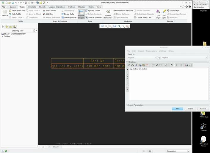

You actually don't need to create special balloon to place many balloons for the same item in the repeat region. You don't even need to create separate index column.
To place manyballoons, e.g. on different detail views,for the same item in the BOM, you need to change the type of repeat region to Custom (by default it is set to simple) and then Retrieve the balloon symbol from the symbol library. When there's no balloon symbol in the library, open Simple balloon symbol and save it to the disk.
Procedure:
BOM Balloons menu > Change Type > [select repeat region] > Retrieve > [select BOM balloon symbol from the library] > Done/Return
To add additional balloons for the same item, split them.
