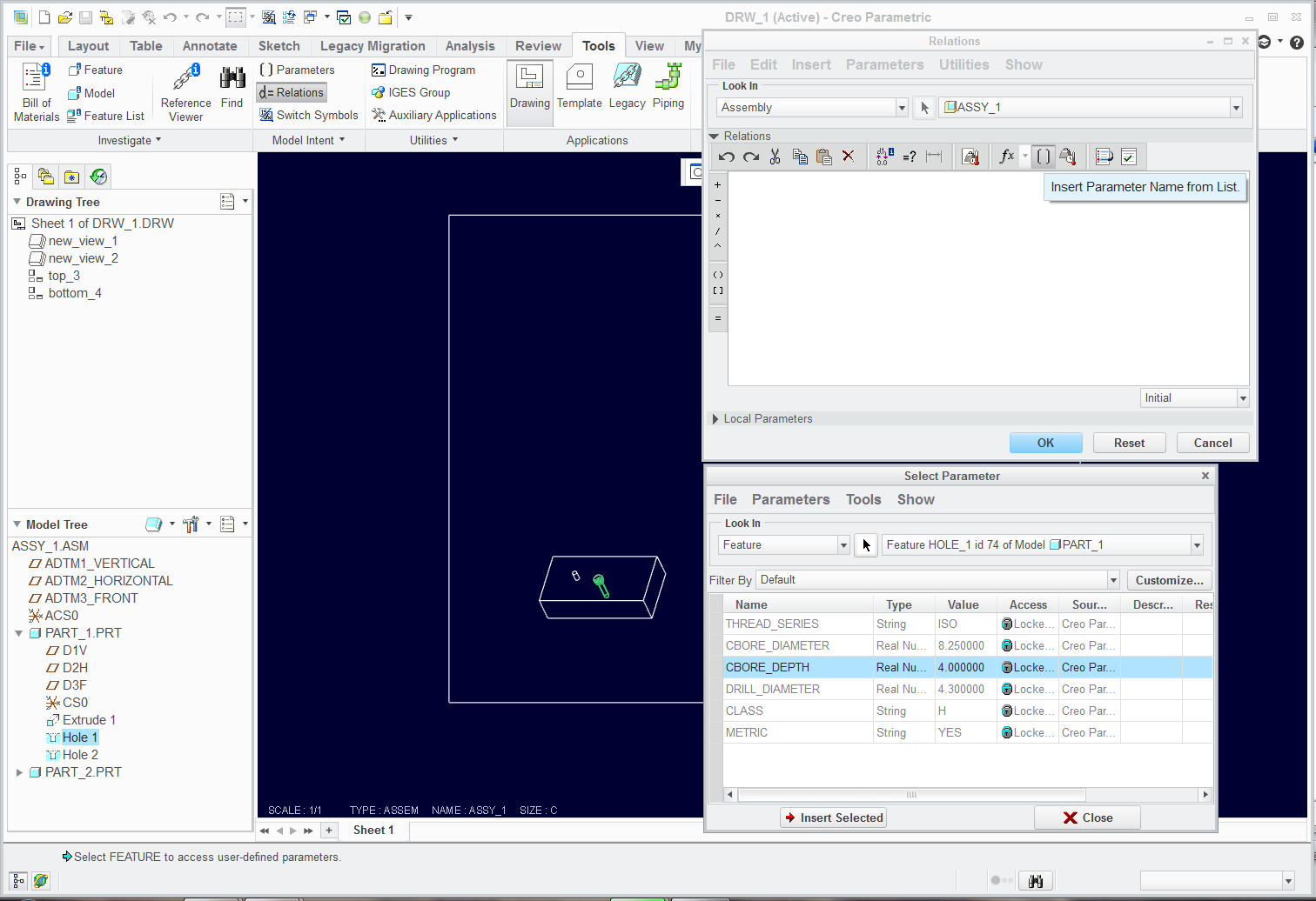

I am not sure if WF4 has the same or similar interface to Creo that is why I didn't add it... but there is a button in Creo that lets you get to all the parameters of any feature, part, assembly, etc.
See if any of this looks familiar. You should have an Insert Parameter button somewhere... you should have the features shown in the model tree (for ease of use)... and you select the feature in the Parameter list and Insert Selected. Then you build the relation you want.

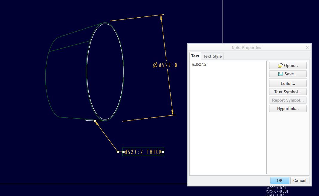

Show Annotation and pick the part or feature in the model tree. Once you show it, you can get the code by with Switch Symbols.
February 13, 2013
I guess the syntax is &dnnn:N where "N" is the assigned number to each part in the assembly, not specifically tied to the part itself. This makes sense when you have multiples of the same part, I guess.

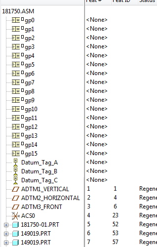

Tony, the above syntax you offered isn't working. See picture for clarity.
I'm trying to reference d259 in part 181750-01 in the tree.
I've tried
&d259:5
&d259:52
&d259:1
It just takes the & sign away from the note on some of the attempts.

The relations worked also. Do you have a reference website or document explaining the syntax of the relations? I'm unclear why
VALUE1=CBORE_DIAMETER:FID_74:0
VALUE2=CBORE_DEPTH:FID_74:0
was typed the way it was.
February 14, 2013
