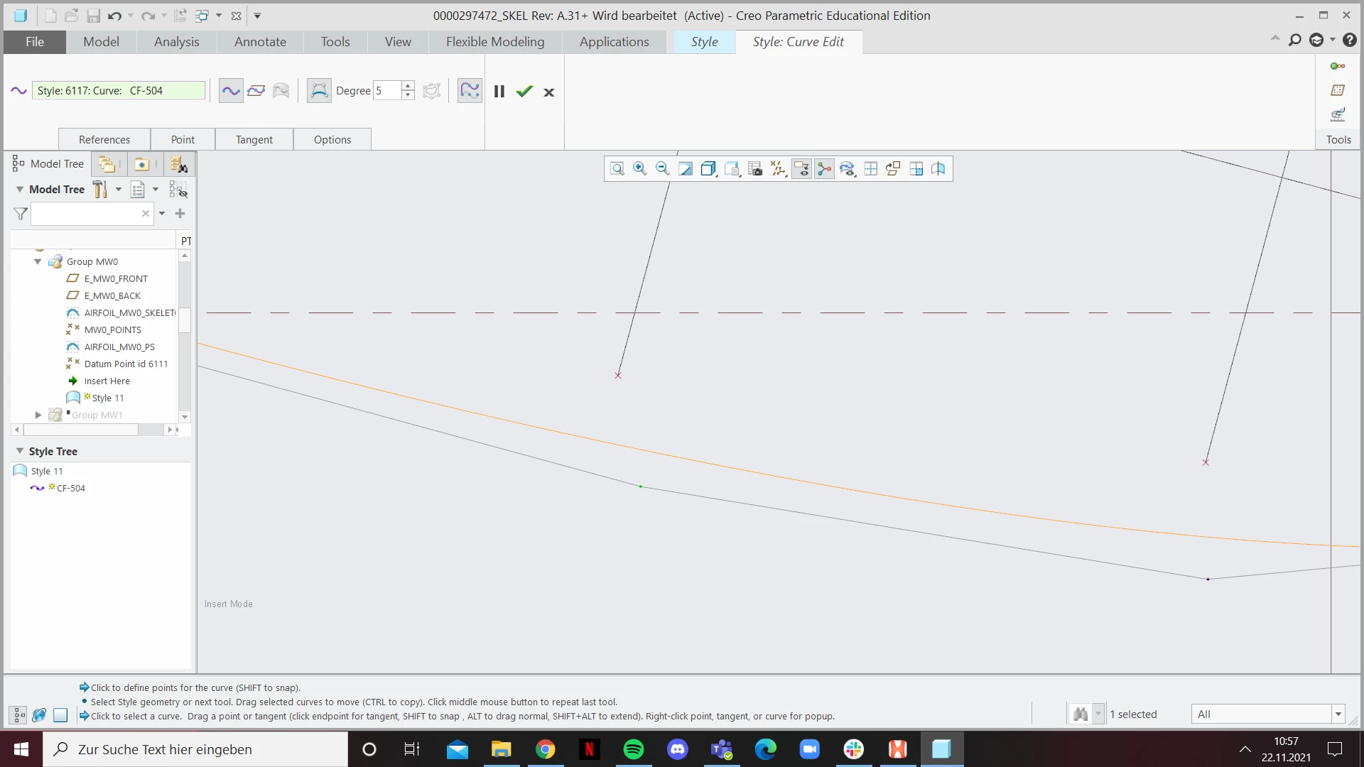

I am trying to use a curve for creating airfoils. My geometry requires a smooth curve. My control points have to refer to points, which I referenced by parameters. So, I want to change the spline geometry with points, which are referenced by parameters.

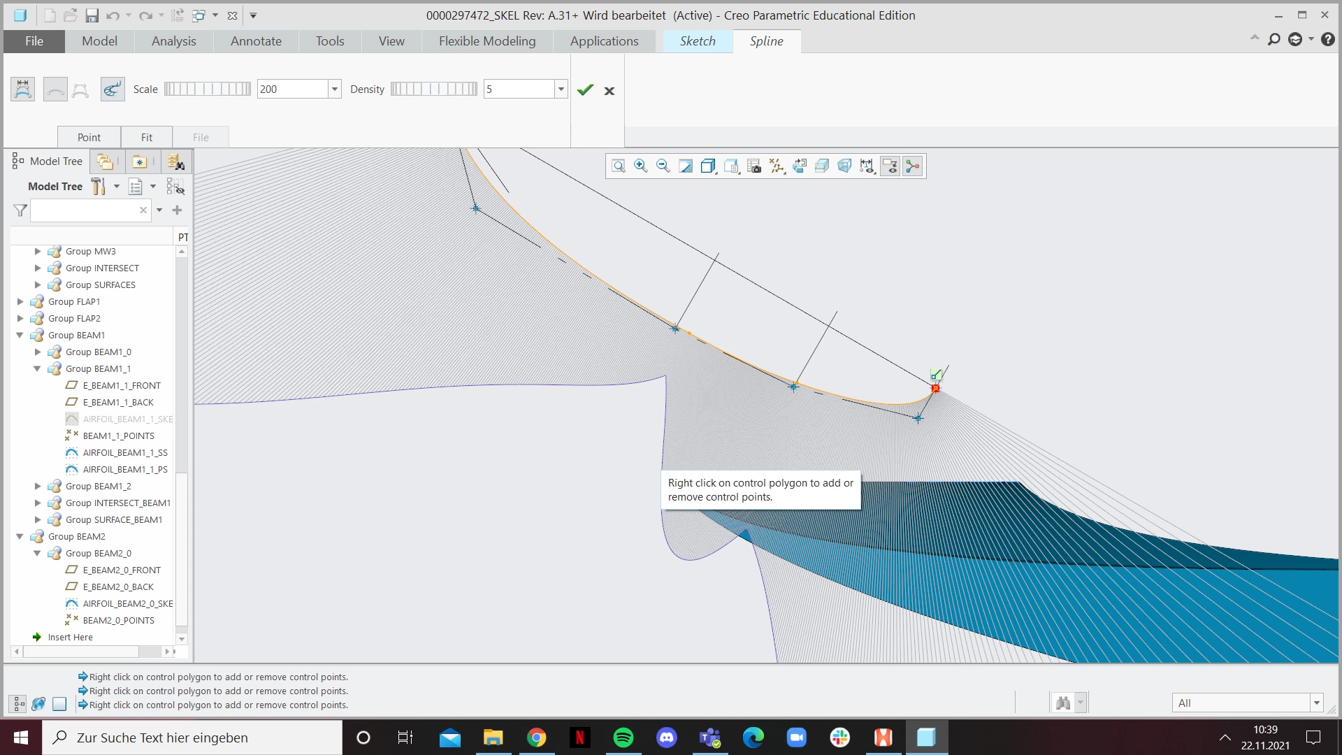

For a smooth curve, I try to use G3-curves. However, with using splines I get kinks in the curve since splines do not have the G3 continuity feature.
If I try the Style Tool, I can use ISDC degree 5 curves, but I cannot reference my points. Only the start and end point are snapped by holding the shift key, but not the other points in between them.
Is there a feature to model the spline as a G3-curves or to reference the control points of a style curve?

Control points of splines and ISDX curves cannot be used as a reference for other features. You can define datum points for the spline/curve to pass through that can be controlled directly. Have you considered this approach?
You can also import an .ibl file and use this for a curve through points approach.
kdirth
Not quite sure how you are trying to reference the points.
If you are trying to go through the points with your curve, you can hold shift and select each point in order.  The ends can then be controlled using the tangent tab.  If you need to control the curve at each point you will need to make multiple curves from point to point.
