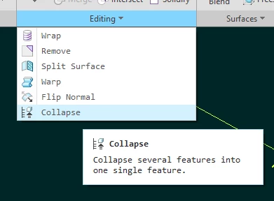

For (1), I'd say the easiest is probably to open the part, select the copy feature and then use the "collapse" function to turn it into static geometry:
pausob_1-1675285135494.png -->

To provide some context to the solution offered by @pausob , see this link.
How to use collapse geometry:
https://www.ptc.com/en/support/article/CS59684

To build on @tbraxton suggestion of using external copy geoms -
if extern copy geom is set to be completely independent (no dependency) then the link to the original is severed and cannot be re-established.
If set to be "manually updated", it will not auto-update if original changes - but the dependency remains.
IMO, if you are going to use the "no dependency" option then the copy + collapse method is just faster.
I find one good way of collecting the geometry from multiple places in the assembly, which I want to turn into static reference in a new model - is to use the "Shrinkwrap by manual collection" method, as showcased in this video:
https://youtu.be/5A2vWMocYvs?t=482
(I think you have to have advanced assembly license for this)
I then collapse the external copy geom feature that the tool made in the new model and go from there...
