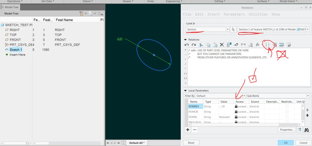

My goal is to reference a defined local "sketch feature" parameter from the "sketch section" associated with the same sketch feature.  Intent is to define a sketch dimension to the value of the parameter.
Creo help suggests that the way to do this is by qualifying the parameter name with the feature ID, such as:
    <param_name>:<feature_id> or :<feature_name>
or perhaps
    <param_name>:FID_<feature_Id> or :FID_<feature_name>
both forms have been tried.  These referencing syntax forms are not working.
Example:
  Sketch SK_123 exists with Feature Number 10 and Internal Feature ID 50 (obtained via Feature Information).
  Within "Feature SK_123 id 50" (given in the Relations dialog when "Look In" is "Feature") parameter ABC is defined.
  Within "Section 1 of Feature SK_123 id 50" (given in the Relations dialog with "Look In" is "Section") is relation sd0 = ABC:50 (or ABC:10 or ABC:FID_50 or ABC:FID_10 or ABC or any of the other variants noted above), where sd0 is a dimension.
Result is:  "Relations have errors"
If I do not qualify the parameter name, then a Part level (top level) parameter is created which is what I do not want.
Any ideas how to make this referencing work?  Thank you.

I think the problem is that section relations (that is, the ones that have the sd0 "sketch dimensions") can only reference part parameters:

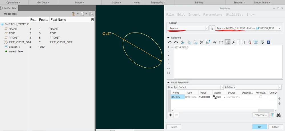

However, you can make a sketch FEATURE relation that can drive the generated "feature dimension" to be equal to the value of other parameters in the model, including its own sketch FEATURE parameters (in which case, the :FID_xxxxx syntax is unnecessary):
note how there is that bit of that magic that happens as sd0 becomes d27...  I never really understood why Creo works this way, but...

Yes that worked!  Relations within the section are locally solve, but with this approach it appears the relation results are subsequently "pushed" into the section.
After I made the change, two re-generations were required to get all geometry to update so seemingly the 1st pass re-calculation resolves the value within the sketch feature, then the 2nd pass re-calculation provides that value to the section (and other things are dependent upon that section so they did not update initially).  Depending on how many times calculated values pass from sketch feature to section, it might imply the number of necessary re-calculations could grow to well more than two.  Likely to potentially confusing to subsequent users of the model.

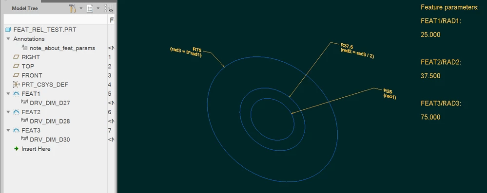

Well, not sure why you needed 2 regenerations; your explanation about the sketch section updating only after the sketch feature parameters are updated does not sound right to me.  Also, the feature order does not determine the evaluation order, as demonstrated here:
feat3 has relations which make it depend on feat1 parameters
similarly, feat2 depends on feat3
after modifying feat1 parameters, only 1 regeneration is required to update all features.
2 regenerations imply some quasi-circular (semi-circular?) logic..  I would look into the "sort relations" function to see if that eliminates your issue.
