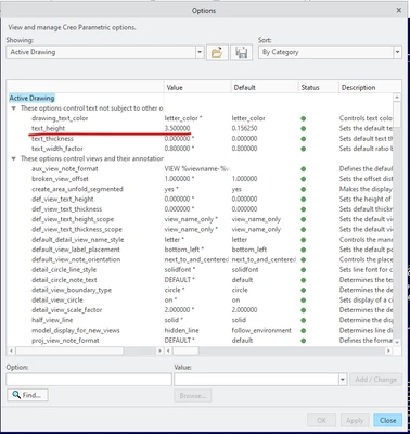

See Default text size - PTC Community
You can save this in your template, so you always open it like that.
