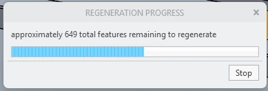

Hi, in an assembly "A" I have a lot of this parts "B" (lets say 100). When I modify another subassembly "C" (or parts "D") of the assembly "A", It takes a lot of time to regenerate the 3D model "A", and in the left bottom of the screen it plot these messages
"Relations have errors/warnings. Refer to the message log for the details or visit relation UI.
A - assembly A - regeneration completed with 94 suppressed feature(s) or component(s).
Part 'B' not changed since last regen".
I think it is a tentative to regenerate parts that are not in checkout and takes a lot of time to do this tentative.
How can I fix this problem?
Thank you in advanced.
Michele Barile
7 replies
It appens for every modifies: if I modify a subassembly, a part, add a new part, modify another flexible part, etc...
It restart to regenerate 1500 features and takes a lot of tyme.
出现这种情况一般是出现警告造成的,就是那些红色或者橙色的叹号,所以要解决重生问题需要先解决叹号问题
I have not exclamation mark, I have only orange triangles in my features tree, and it happens when the workspace is new too,
