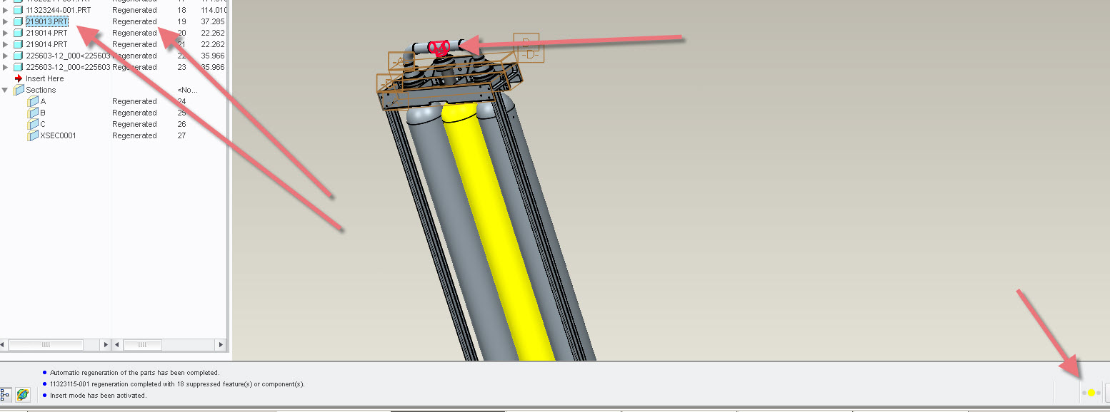

I have a fairly simple assy. Regenerates fine but I get the yellow light. I start looking and it turns out one of the components actually has a failed placement feature.
Nothing I can find tells me where the problem is. It's like it trying to hide the failure.
I can use the search tool and it won't find anything on the status that is not perfectly regenerated.
I have freeze failed components turned on but a co-worker doesn't and he see the same thing I see.
My question is, why is it regeneration status or the model tree or the search tool or something point me to the one failed placement constraint?
If this was a large assy with possibly several placement issues, I would end up spending hours searching for something that should be easy and obvious to find.
