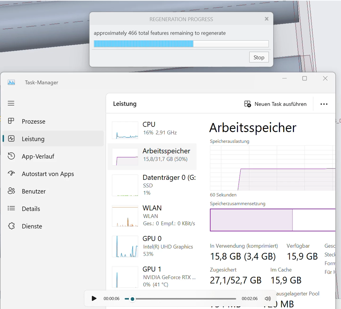

Dear PTC Community,
i am designing a radiator, and therefore i would like to makes a pattern of the fins.
i understand that a pattern with over 500 members takes some computing time and peromance.
However, the pattern takes an eternity (5mins) to regenerate but my computer is not at all at its limits (see picture).
i am working on a windows 11 pro and creo 9.0.9.0
(Arbeitsspeicher means RAM)

during regeneration Creo uses single processor core. Creo cannot "employ" all processor cores during regeneration.
Note: If you have 8 cores and Task manager tells you that processor load is 12% then you have to multiply 12% by 8 to get 96%. This 96% tells you how much of processor power is Creo using.
To speed up regeneration you can probably set different pattern type.
General ... longest regeneration
Varying ... middle
Identical ... shortest regeneration

To add onto what Martin said, you can put features into read only mode so if you don't need that complicated geometry regenerated after you make it, look into operations -> Read only
