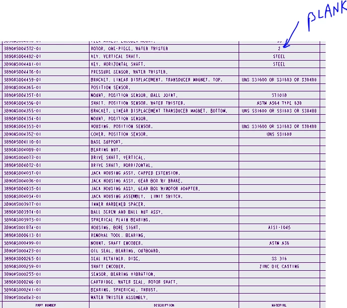

I am looking to blank certain cells in my bom that have the parameter "material" in the repeat region.
How do I write the relation?

wfalco16-PearlAuthor
October 23, 2019
Martin,
My parameter is "material".
I tried both:
IF asm_mbr_material=="2"
material=""
ELSE
material=asm_mbr_material
ENDIF
material2=""
ELSE
material2=asm_mbr_material
ENDIF
Neither work. I am most likely misunderstanding.
The first one makes sense. The second one adding "material2" does not make sense.
Oddly enough both are accepted. However the "2" remails in the matrail column.
Wayne
