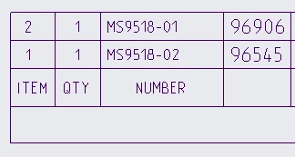

I have a parameter called cage_code. I want the blank cage code in the bom column to read 96906.
I have another parameter called part_number. I want part_number MS51959-15's cage code to read 96906, which is currently blank.
I saw a tutorial on Youtube that showed the following relation that worked:
IF asm_mbr_part_number=="MS51957-15"
asm_cage_code="96906"
ELSE
ENDIF
This looks pretty straight forward and looks like it will work. Why does it not?
Do I need to do something to the cage code in the bom that reads &asm.mbr.cage_code? I tried something like &rel.asm.mbr.cage_code. That does not work.
Please help.

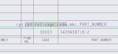

The way I have handled this in the past is add a new repeat region relation parameter for the cage code, in my example, I use "new_cage_code".
I change the column in the table from asm.mbr.cage_code to rpt.rel.new_cage_code
new_cage_code=asm_mbr_cage_code
if asm_mbr_name=="MS51957-15"
new_cage_code="96906"
else
endif

StephenW
Oct 29, 2024 12:29 PM UTC
There is always something that snags these up!
Does that part file actually have a cage_code parameter, sometimes thats the snag, and I sure don't remember how to fix that...
Unrelated:
Also, I noticed,  I used asm_mbr_name=="MS51957-15"  but when I looked at your setup again, you used asm_mbr_part_number=="MS51957-15"
So try changing to your relation to IF asm_mbr_part_number=="MS51957-15"

Oct 29, 2024 5:49 PM UTC
I got this to work.
Drawing repeat relations are:
IF asm_mbr_pdm_number=="MS9518-01"
else
if asm_mbr_pdm_number=="MS9518-03"
asm_cage_code="96907"
else
asm_cage_code=asm_mbr_cage_code
ENDIF
endif
MS9518-01 has a blank cage code, -02 has cage code 96545.
