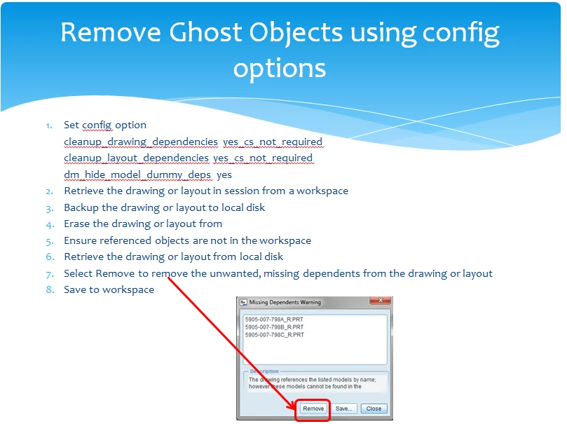

What is that config option? I'd really like to turn this on, especially when the references are damaged, or missing.

Chris, I think these three params are what you are looking for.
cleanup_drawing_dependencies yes_cs_not_required
cleanup_layout_dependencies yes_cs_not_required
dm_hide_model_dummy_deps yes
[cid:image001.png@01CF8C66.43FE8420]
Once you are done cleaning up, comment them out or change the value to NO. Per PTC, you do not want to leave them in your config set to yes as default.
NOTE: DO NOT ENABLE THE CLEANUP OPTIONS BY DEFAULT
* Many dependencies which initially appear as ghost objects or default references may be valid and should not be removed. If the cleanup options are applied indiscriminately, it is possible to remove dependencies which were used in the drawing or layout (For example: After cleanup of a valid depedendency, a drawing cosmetic reference may have asterisks "***" in place of the value(s), or an external reference parameter may not update correctly when the layout parameter is changed.).
* Enable the options when attempting to cleanup specific drawings or layouts
* Retrieval performance is significantly decreased when the cleanup options are enabled as Pro/ENGINEER or Creo Parametric will automatically search the Commonspace for each missing object during retrieval
Good Luck!
