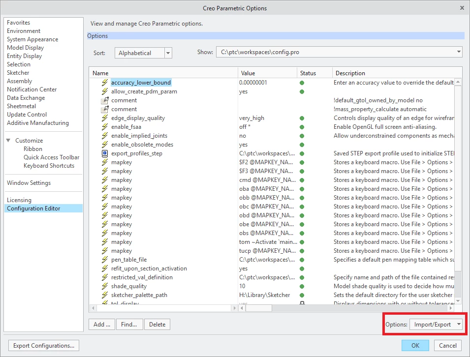

Reload Mapkeys (config.pro) without restarting Creo?
Is there a way to reload manually edited mapkeys without having to restart Creo?

I don't know if the picks are the same in 2, but in Creo Parametric 4.0 it's File, Options, Configuration Editor, Import/Export.

April 5, 2019
Yes, just re-read (open/import) the config file that contains the mapkey.

Well it's probably right in front of my nose... but I don't see how to do that...
