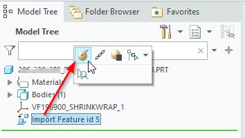

I'm exporting single bodies from what originally seems to have been a multibody STP that have been imported into Inventor and saved as an IAM file (Inventor Assembly file). I export these as STP and then import into Creo and then save again as PRT. Although a bit tedious it's still a lot faster than re-drawing them from scratch (especially as I have no drawings).

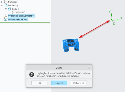

Now, in the export procedure the part CSYS seems to stay where it originally was in the much larger multibody, causing my new assembly to have loads of free-floating CSYS practically EVERYWHERE (see first image). Not a huge deal for functionality, but it feels bad. 🙂
THE QUESTION: Is there anyway in Creo to adjust the relation of a no-feature body-only part to its CSYS? (see second image below) I've tried to just delete them, but that deletes the whole body.

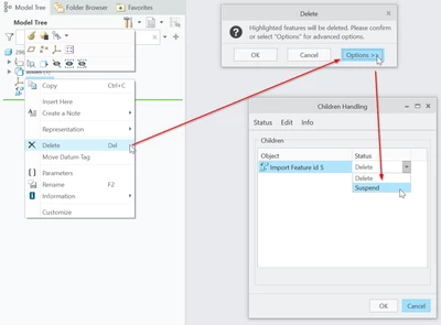

Dec 1, 2022 3:04 PM UTC
In addition to the already posted solution I also found this to work:
- While deleting the faulty CSYS, choose Options and then set the Import Feature to Suspend. This will disconnect them and the geometry will remain. Then a new CSYS can be set.

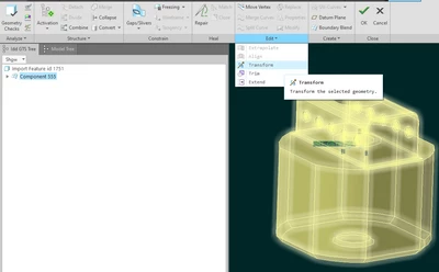

Use the Import Data Doctor to edit the import feature and move it's geometry to the "correct" place.   You can also use it to delete the coordinate systems generated in your export/import workflow.

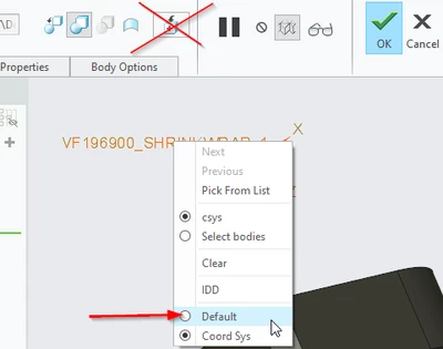

Dec 1, 2022 11:00 AM UTC
I opened the IDD, but could not figure out how to move the geometry. But half-way there I did find out how to solve the problem:
1. Edit the Import feature:
2. Right-click the CSYS and select Default
3. Click OK. In the regular model tree the CSYS can now be deleted without loosing the geometry.
4. Create a new CSYS and position it where you like.

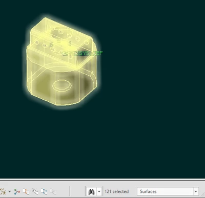

Interesting, it seems your STEP import process results in the import feature being placed relative to a previously defined coordinate system (VF196...).  Then the procedure you document here redefines its placement to be based on part's default CSYS.  BTW, that right-click menu has the same function accessed via the placement tab:
Anyway, if you want to move the geometry, enter IDD environment, then select the component, and then use "transform"
You will then have the means of relocating it using the functionality typically found when placing a component in an assembly.  Kind of weird, and this means that some (temporary) construction geometry might have to be made above the import feature to have the placement references when IDD transforming it.
If it's just a shift to "center" it on the default CYS, I just note down the distances needed and then use the "Move tab":
(you can type in a specific amount in the "translate" box)
If your imported geometry comes in as multiple components, then it might be better to transform after selecting all surfaces in the import feature; fortunately, that can be done with a box-select (after setting the filter to "Surfaces")
Definitely tedious, but sometimes necessary or it's just a nice thing to do; you don't want to check-in an imported model with a slapped-on CSYS when its geometry is off in outer space relative to the "default" CSYS - as this causes issues with drawing views, etc...

EdvinTailwind13-AquamarineAuthorAnswer
