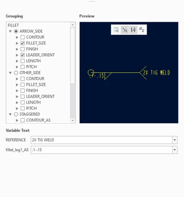

Remove All Around Symbol on Weld Symbol
A weld symbol on a drawing specifies all around but it needs to be changed. The weld symbol was created in older version of Creo (4.0 or Wildfire 5.0) but where is this option located so it can be removed.. What is being overlooked?

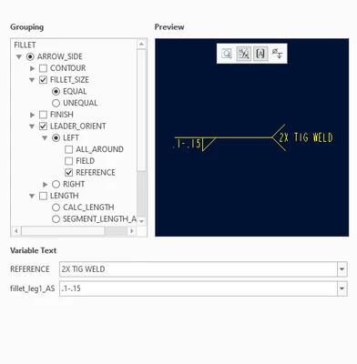

DUH...
Expand the arrow heads...
