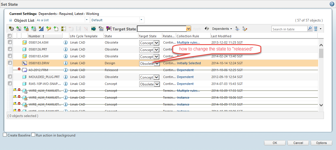

2.How to change the life-cycle state in PTC Windchill for the CAD drawing?
I look forward to hear from you. Thanks very much!

That green border in the cell looks like a selection box. If that is not the case, then the box may be a part of the format used to generate the drawing. Unfortunately, if this is the case, it may not be selectable. The only way to fix that would be to apply a new format that does not include the green box geometry.
As for changining lifecycle states: this process will depend on your Windchill configuration. IIRC, out-of-the-box, shifting lifecycle states outside of the defined promote/revise process usually requires someone with an administrative role (Product or Organizaion Admin in Windchill).
