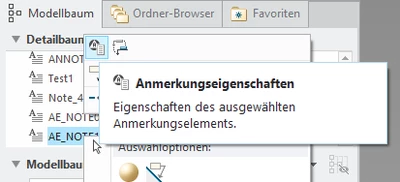

The difference between selecting an "Annotation Feature created Note" and a "regular Note" while the quick access menu pops up:
"Annotation Feature created Note" - (edit) "Annotation Properties" and no "delete" option
Note - (edit) Properties and there is a "delete" option

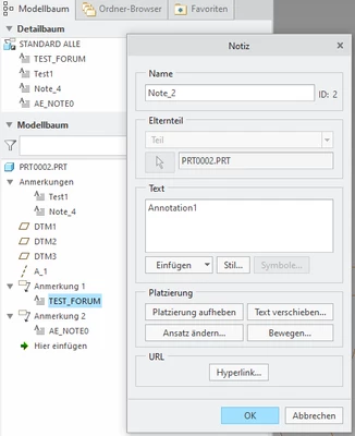

Select "Annotation Feature Note" > Annotation Properties > enter a "same specific Name" (doesn't change appearance in the Trees)
Select "Annotation Feature Note" > right mouse button > rename > enter a "same specific Name"

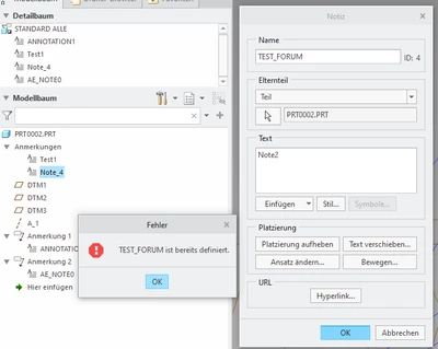

-> When repeating creating a Note or an Annotation Feature I cannot give the same specific name!

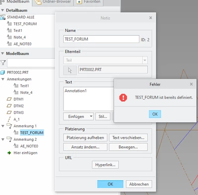

Select Note (Detail tree) < (edit) "Properties" < enter "same specific Name" - Error: "same specific Name" is already defined

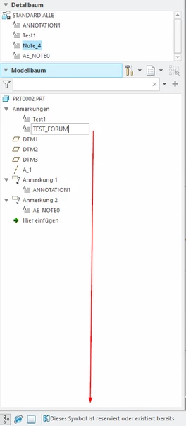

Select Note (Model tree) > RMB > rename > enter "same specific Name" - Message: "This symbol is reserved or exists already"
select Annotation Note (Detail tree) > "Annotation Properties" > enter "same specific Name: -  Error: "same specific Name" is already defined

So I noted one little difference with your replicate process:
- after erasing from state and deleting the Annotation feature: I tried to use regular "Notes" -> [renaming] a Note also changes the [Name] (see below), [renaming] a Note embedded in an Annotation feature doesn't change the [Name]
Right now I also just discovered something weird:

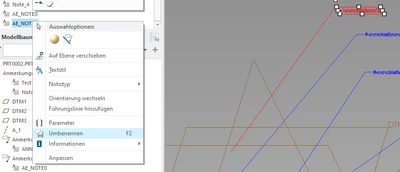

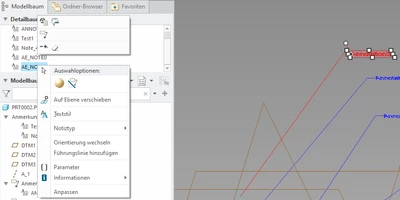

Right after I create an Annotation Feature, there is no [rename] option. I must first select the frame in the 3D environment, then the option is there (I thought I'm going crazy while trying to reproduce the error) - that's probably the reason why I had to go over Properties in the first place

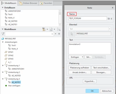

Unlike you, I have no option to influence the Name in the "Format Tab"":
I have to go over "Annotation Properties"
So I change the [Name] - Also works without [renaming] the other stuff, erase the Note from state, delete both Annotation + Note from Modeltree.Nephran_13-1650464331982.png
And trying to change the [Name] of a Note, gives the error.
I can't [rename] the regular note (since this also changes the [Name])
I can [rename] the note embedded in the Annotation Feature, but trying to change its [Name] results in the same error.
